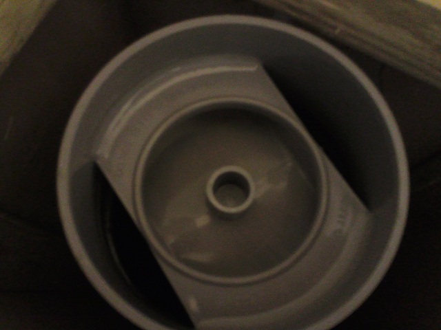

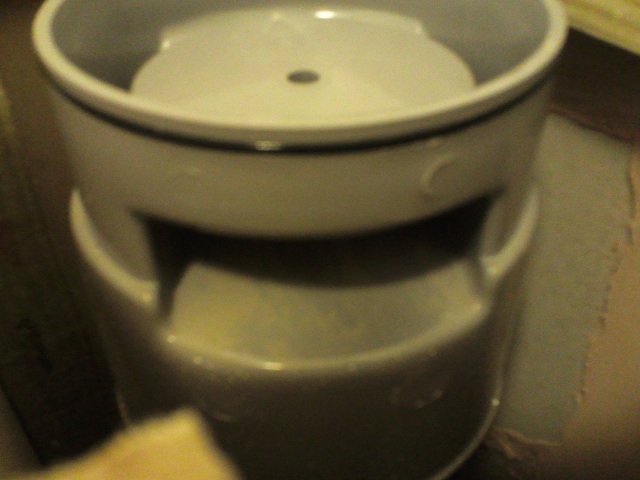

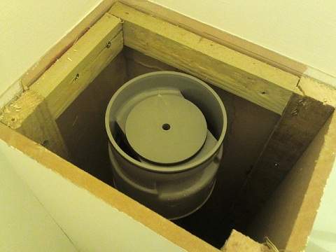

Hi Hope that someone can advise on this problem. Went to a new build house, 7 months, owners having problem with downstairs toilet and main bathroom toilet which gurgles shower trap when flushed. There are 2 ensuite toilets which go to an external soil pipe open to the air, these are ok. The downstairs toilet and main bathroom are in the middle of the house and have seperate soil pipes going straight down through the building, each has an air admittance valve on top and are boxed in. When flushed the toilet bowls fill right up before draining, I gained access to the valves and removed the top covers opening the soil pipe to the air and both toilets flushed normally, the shower didn't gurgle. I dont know a great deal about these valves anyone have any ideas on how to overcome the problem. Many thanks in anticipation.
Finally got back to house, first task was to rod drains to check for a blockage, removed man hole covers and discovered this, as toilets were flushing without AAV never gave a thought to lifting them prior to this, these are downstairs toilets. Main bathroom was blocked too, but not to this extent. The white pile on the right of picture 2 is baby wipes. So cleared all drains eventually and toilets flushed perfectly. Looks like Koogatubac was right. Put some grilles on boxing in as per system3 recommendation and went home for a shower. Thanks to all for input.

Well done mate, right on the money this time, baby wipes would you believe yes I would/should as that was exactly what happened at my house.Either way fitting the grille to the AAV was a good call as well.
