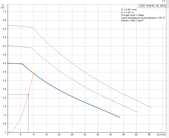

Here's a example, using my system which has a UPS2:
The required flow rate and head are 8 litres/min at 2.2m. The actual working point, shown by the yellow dot, is 9.99 lpm at 3.43m which is where the pump curve and system curve (red line) meet. See graph below.
If a PP setting is used, it needs to provide the required flow/head not those obtained by the fixed speed setting.

That just gives you the working point when that particular pump is used. That may not be the same as the required working point.
The attached UPS2 file is corrupted,
Yes, exactly, if you need 8 LPM @ 2.2M head then the UPS2 will NOT do the job in PP mode at its max setting of 3M, it will only give 6.8 LPM @ 1.53M, just put 2.2 in cell L10 and 8 in cell M10 of my spreadsheet and just read the result off the graph. You would need a PP capability of around 3.3/3.4 to give you those required numbers.
I really couldn't recommend anyone to buy the UPS2 for this very reason. I will shortly post a modified spreadsheet using a Wilo pump on PP control to give your 8LPM @ 2.2M.
Here you go, using a PP head of 3.3M will give you very close to your required 8 LPM @ 2M, it gives ~ 7.9 LPM @ 2.12M.

At 6l/m the old UPS 15/50 had around a 3m head and the UPS 15/60 around 3.6m head.
The very old Selectric UPS 15/50 and Super-Selectric 15/60 has 7 and 9 foot head, at 6l/min respectively, so a little less. (I say 'has' in the present tense because I know at least one that is still running.)
All the above are on speed 1.
I suppose it would be useful to plot a little chart showing various types of pump curve all on the same axes, so comparisons could be made.
Why am I still up?
Will put together one (chart) later today, I will include my own old Salmson NYL 33 which I installed in Sept 2000 set to speed 2 and was still running perfectly and quietly when I replaced it last November with a Wilo Yonos Pico 1-6 last November.
Here it is, I wouldn't care to be running a few of these on even fixed speed 1, especially the UPS 3 .
I take it that's the old UPS and not the very old one, but it looks wrong. The UPS 15-50 starts at a 0 flow at 3.5m exactly, so how are you getting 3.76? Have you yet another IOM, as that differs from my data?
You posted
I got it from one of your files above... "Selectric UPS Old Style" page 1 shows speed 1 curve starting at 3.75/3.76M ?.
Why am I still up?
Can you post any links (charts etc) to a UPS 25-50 Selectric, power outputs 40W, 65W & 95W. (installed in a new build house in 2005/2006), still running.
Thanks.
