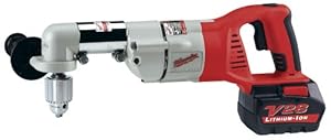

you could also consider a milwaukee m28 angle drill if you want a cordless one that can do what the smaller makita can. ive had one for years and you have to buy it from the usa but its a monster and its cordless.
