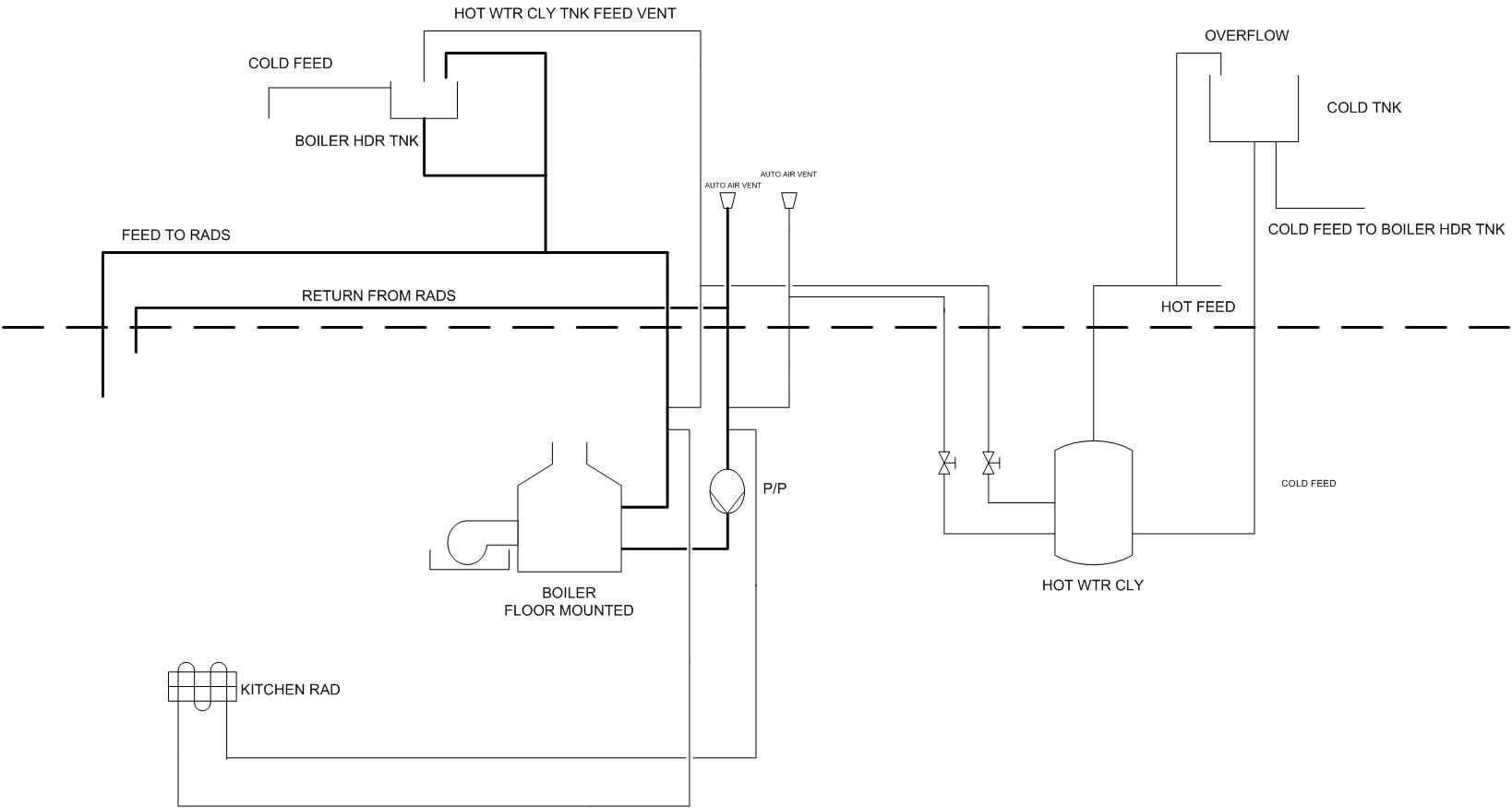

1: He had a vent/overflow pipe on both flow and return lines from boiler. Is this normal?
2: He had no safety by pass valves in case of all rads been closed, the hot wtr cly v/vs are allways open so it acts to allways allow flow i think?
3: The feed water line was angled down from the tank down to the main boiler riser, about a third of the way down it was tee'd and from here the overflow vent went back up very high above the header tank and came back down and dangled into the tank.
4: The main return line was tee'd as it left the attic and huge overflow vent pipe ran up the ceiling to dangle back down into the header tank.
I investigated the attic and their hot water tank was rotted badly and had blocked the feed to the boiler line.
So what I did was:
1. I replaced and replumbed the tank.
2. I followed his design of boiler feed and tee'd the overflow as indicated in the below pic.
3. I replaced the return line overflow/vent pipe with an auto air bottle vent.
4. I added another auto air bottle vent onto the return line from the hot water cly.

What size are the pipes going to the problem radiators? Is the pump on its highest speed?
Hi. You show gate valves on the F&R to cylinder. Run the system and turn off one of the gate valves (water will take the easiest route) Check that the auto air valves are functioning. Check the pipe work as to the progress of the heated water along the offending run. When venting the rads with this problem remove air valve at top of rad and discharge full bore into a bucket for say 10 seconds. (Its best to turn every rad off and do the a fore mentioned on both F&R) this will pull any air in the long flat run into the rad and out. If this has the required effect, rads start heating up. Look at the possibility of fitting a zone valve to control hot water circuit.
Thanks very much for all the advice guys, Justlead1 is the winner woo hoo!
Shutting the flow into the cly was just enough when combined with the highest speed setting on the pump.
Had a massive blast of air but now I have three blazing hot rads and can get on with the job of balancing them.
