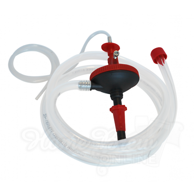

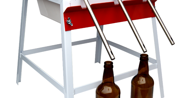

Had a little more thought on this (my mind tends to drift) any of these any good? Bottom one seems best to me.
The first one is no good for the purpose. The other too merit further consideration, though I need to work out exactly how they work before thinking of making an order. Thanks mate!
