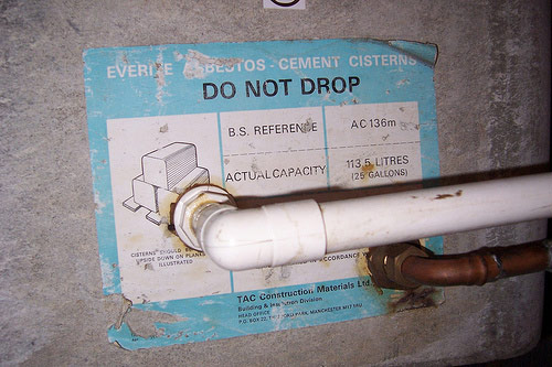

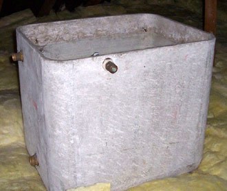

Here's one:
The tank in the photo is asbestos cement, as others have said harmless if left alone ie don't cut or drill it creating dust.
