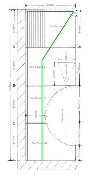

A new basement lightwell is being created with a grill at ground level over the top. I wish to re-route the existing clay soil pipe around the lightwell walls in plastic as it currently runs right through the middle just below ground level. See the attached diagram - the proposed drain route is in red - existing route in green.
Reading other posts it seems that building regulations say that above ground drainage has a maximum length of 6m from WC to stack. Does this limit apply from stack on the way to manhole? The pipe is below ground level but only about 200mm and would be attached to the lightwell wall. The width of the light well is circa 1.5m and the length 5.5m making the length 7m before it would disappear below ground on its way to an existing manhole. So does the 6m apply in this case? If it does Is there anything that can be used to break the 7m that would make it comply with regs.
