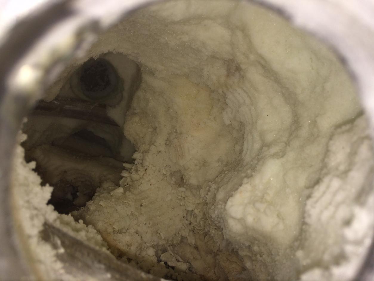

It had a little bit off scale in it
That's impressive.
Were they using the immersion, or boiler to heat it? ( or both and didn't realise!)

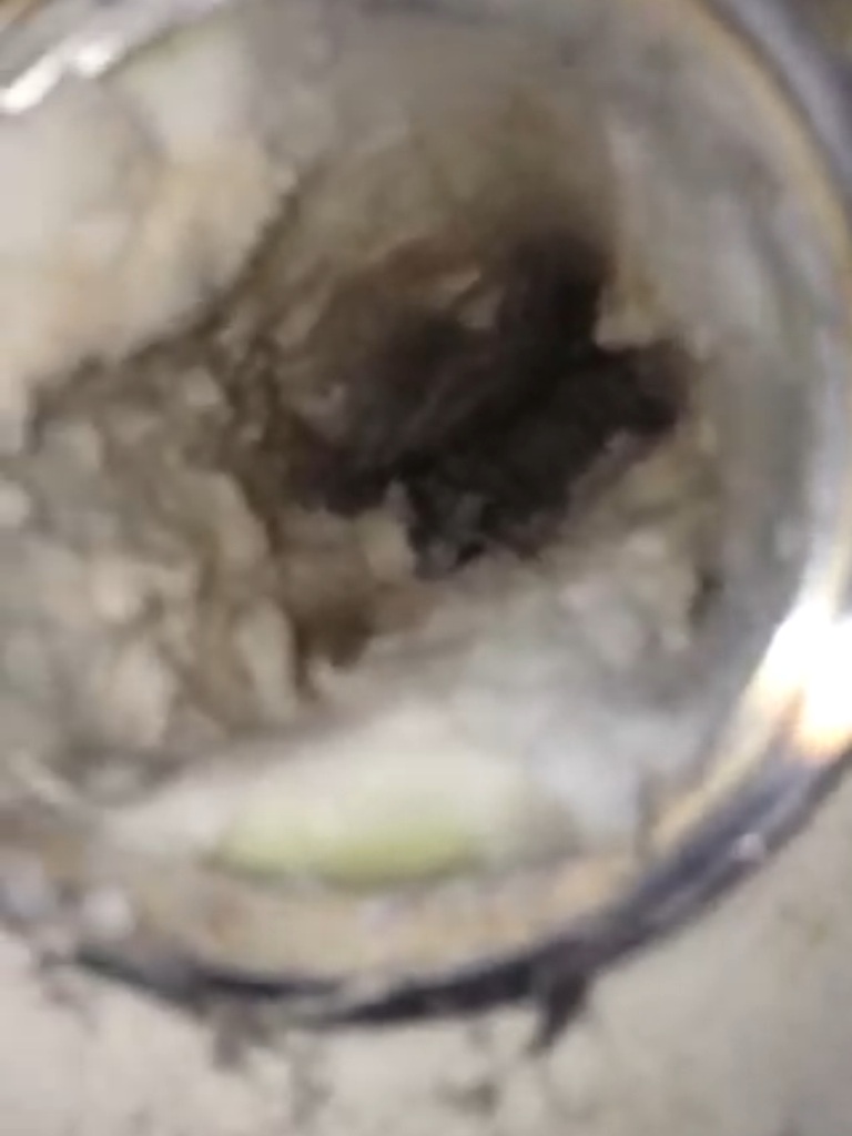

image.jpg Nice and clean , still bits stuck on coil , unable to budge as mega flow immersions are small
Tap filters block none stop , told hi to leave out , flexys on hot also getting blocked ,
They moved in 10 years ago , There was a water softener there when they moved in , but never new if it worked , I found it on the bye pass mode

Jesus Christ that's the worst I've seen. Agree with josh good job cleaning it. Last time I did one the water took a week to settle btw. Flushed it a few times hot and cold first too.
You could use that photo to promote fitting scale reducers for sure.

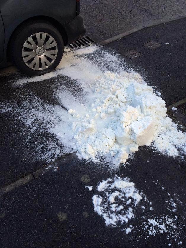

had to cut the cylinder open to move it and got 3 wheelbarrows full of lime scale!

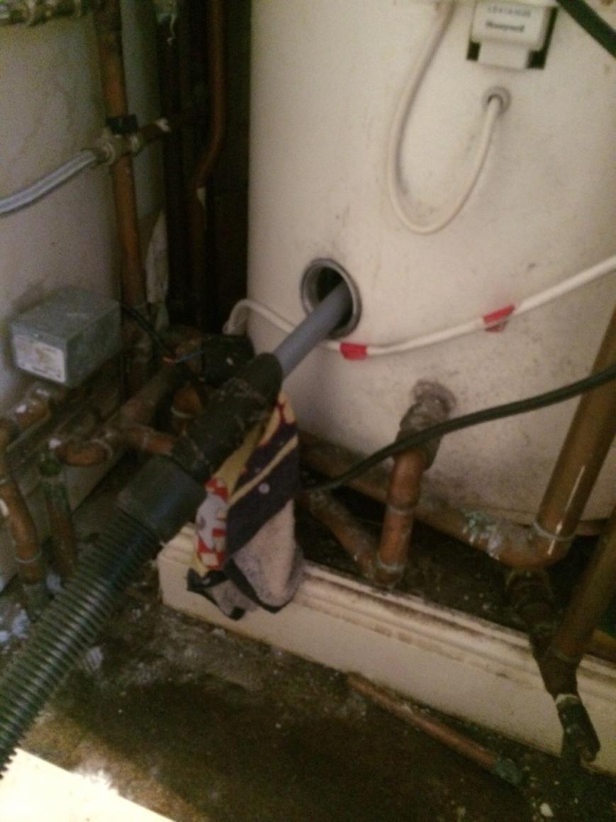

what did you use to clean it out?

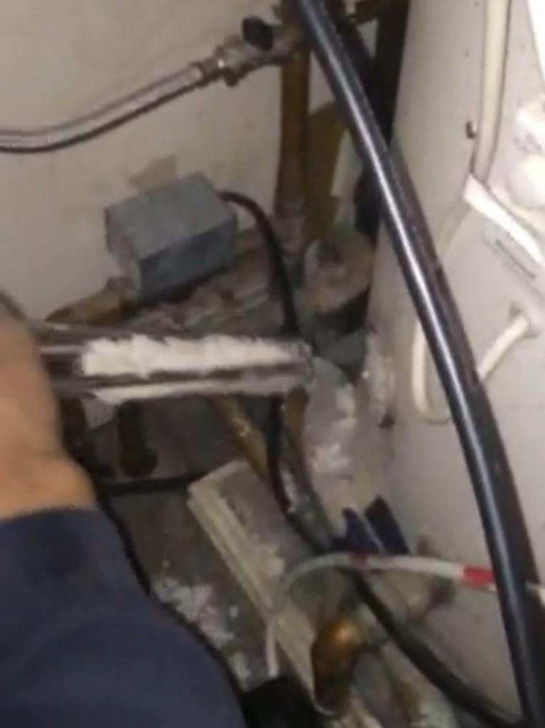

A piece of 32 plastic pipe
wet & dry Hoover with 22mm poly pushed in nozzle , plus using sower hose with extension pipe to flush out , scale ,
it was like doing liposuckion a fat bird ( or bloke )
