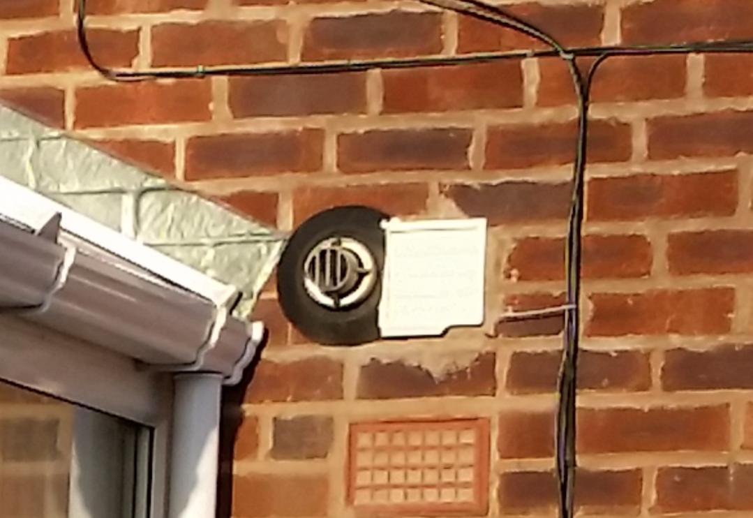

Given the fact that the boiler is barely in use at this time of year (heating not on, shower is electric, and dishwasher for dishes), it sounds like I've got some time to consider this. I'm currently siding with bricking up the vent. Here is a photo of it to show the silly situation I've inherited...

I spoke to gas safe about this and the guy said it didn't have to bee 300 mm away as the flaps are closed and only open when pumping out. Maybe if it had reverse polarity and 2as sucking air in it would be different.
That is close though
Is the boiler fitted above the hob as well!
I presume the flue was altered to allow the conservatory to be fitted?
That is "at risk" for obvious reasons....and the op saying we do not use a lot this time of year...just shows why certain folk need protecting
