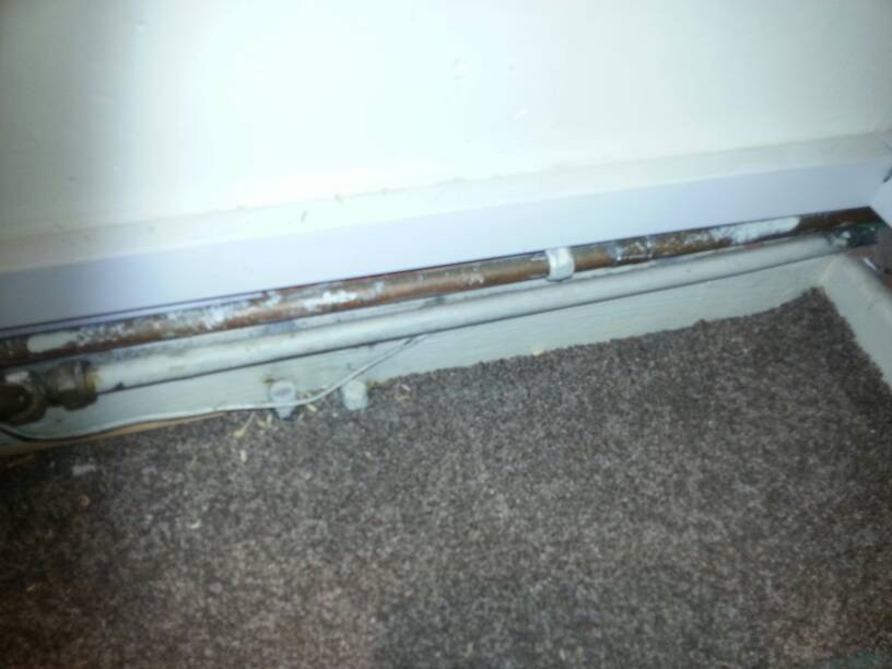

Bloke wants to open and use an understairs cupboard and wanted a water pipe moving so it could be boarded/ skimmed over. Issue is there is the gas cooker pipe running tight alongside the cold main and so the boarding would now make this a cavity. Can't really move the gas as it is tight to the wall and disappears into the kitchen wall.
Suggested a boxing penny vented where the gas runs along the base of the wall.
The bloke asked if he can still board to the floor and vent that (understairs cupboard size).
Any thoughts/suggestions?

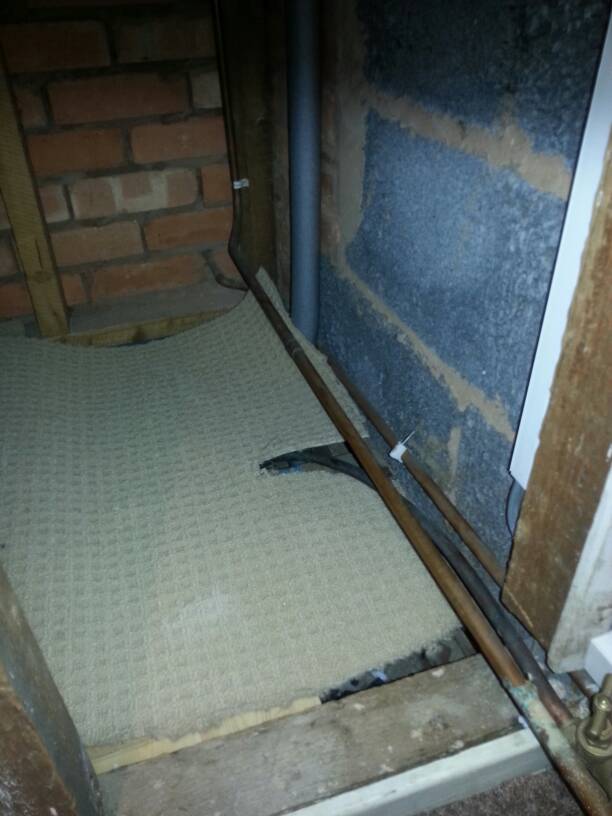

The gas pipe on second pic is on th top.
Gas pipe on first pic comes through brick wall unsleeved at the bottom. The pipe coming through top of brick wall is the water pipe he wanted moving.

Lol, thought about that but runs tight against wall with cold main and electrical trunking. Unable to tape because of this.
Rip it out and re-run it. For starters pipe is not sleeved and its touching the wall without be protected against corrosion, because the wrong clips have been used.
The entire gas carcass is nail clipped in the garage and neither the cooker, fire or boiler pipework is sleeved where they disappear through different walls. Where do you stop? I expect the whole street has been done exactly the same. I only went to move an outside tap pipe lol.
British gas service my sisters boiler every year under contract and the carcass is nail clipped all along the outside wall with no protection and a black bin bag covers the exposed meter. What gets rectified......nothing.
I think he should board down to a timber above the pipework and have a removeable wood panel with penny vents.
Needs access to the stop tap anyway.
It's cross sectional area that's important so 10" sounds like it's going to be bigger than 100cm2 cross section
Rest of its ncs so why worry ? Fix defects before boxing in me thinks?
I would if the one end didn't go into the kitchen behind units sandwiched between water main and cable trunking. No way of getting in to cut the pipe and re-routing that part. Tbh didn't want the job in first place but friends of family and all that.
