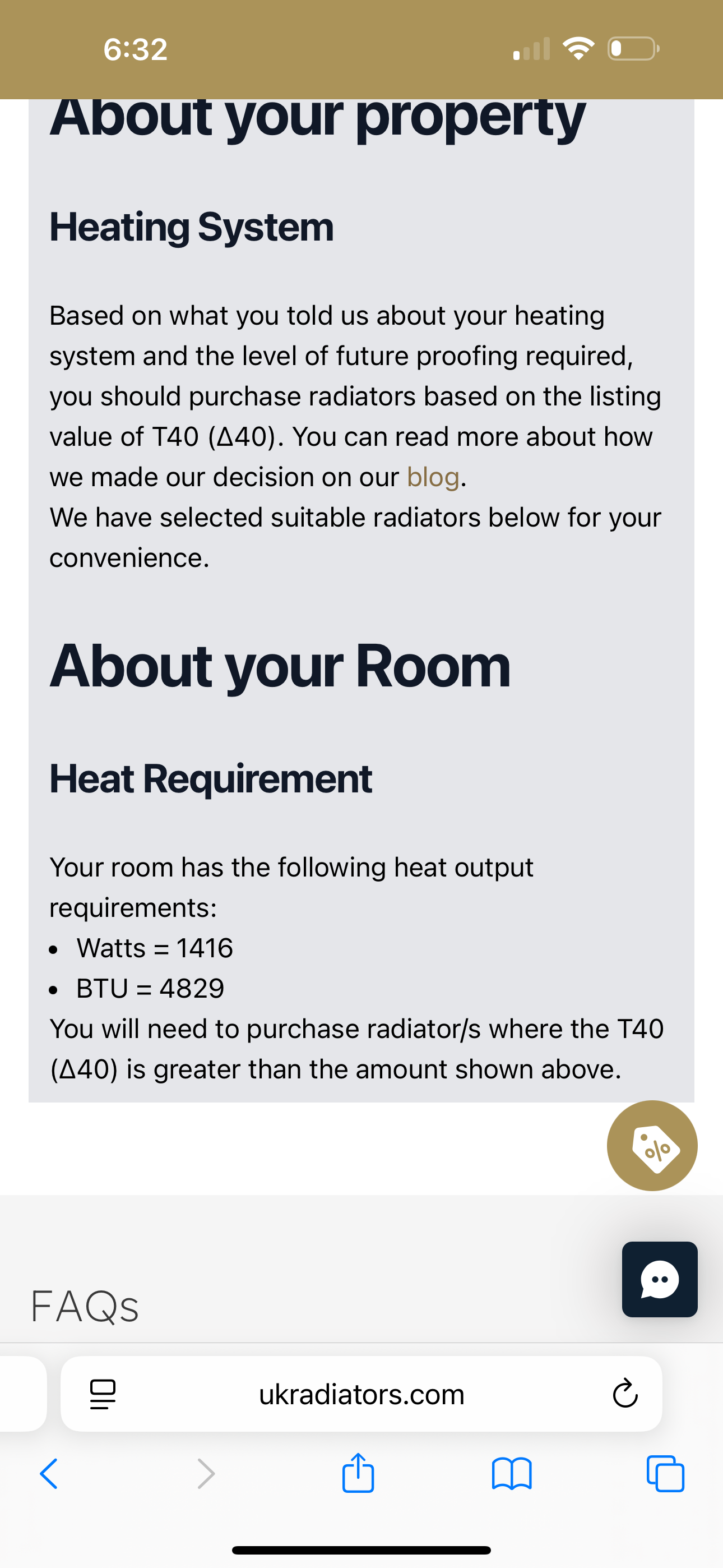

Sorry I’ve posted about this before but now ready to order a radiator. These are 2 different calculations from 2 different sites. BTU 6005 from one site. BTU 4829 from another site, 4829 went through a lot more thorough questions, so I’m guessing the 4829 BTU is correct over the 6005.

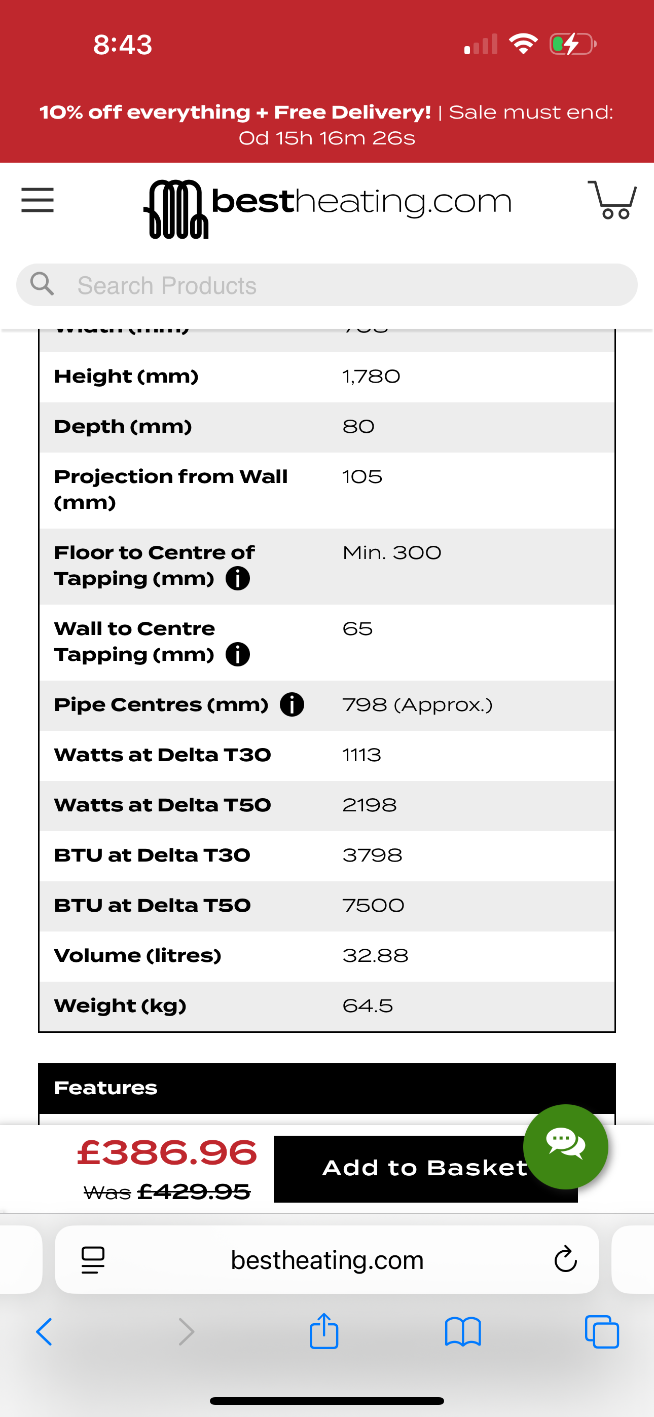

Would this type of BTU/ watts be ok to fit or would I be looking at a lower reading or higher reading thanks. The photo only shows T30 T50. But the first photos shows that I’m T40. Any help would be great as looking to order tonight 🙏🏻
This rad has a max output of BTU 6250 at T50
Checked online and says I should calculate my reading T40 at btu 4829 and x it by 1.33 giving me btu reading 6422 at T50 that I should be looking for, would just like to know this is correct before ordering thanks
Would any of these be suitable? This is the style of radiator I’m trying to keep throughout. And the more expensive out the 2 is the biggest size it’ll go? Cheers for all your help 👍🏻
If the radiator is slightly oversized it should not a problem as the controls for the heating system will restrict heat when the conditions are satisfied.
For example when your thermostat has reached the set temperature it will tell the boiler to turn off. TRV's (Thermostatic Radiator Valve) on the radiation would work on a similar controlling the heat around the radiator. When that are reaches the set temperature the valve closes.
