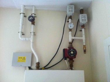

Hi all,
Here are some pictures of the system in the house.
This is in the ground floor utility room:
This is in the second floor airing cupboard:

Your first port of call is to put some water into the heating system your pressure gauge on the big red expansion vessel is reading zero & big clue no water on top floors but still ok on lower.
Do you know were your filling loop / point is ? It should be a silver flexible hose that is used to connect a mains cold water supply to a heating pipe with some valves on either side & a pressure gauge close by?? I can't see it around the boiler so most likely next to the hot water cylinder (high level) ? the other thing we will need to know is how many floor are above this point ?

Ok so this is in the airing cupboard on the second floor:
There is one more floor above this.
That's your filling loop. No need for the gym today your gonna get your excercise running up and down stairs. Top it up to about 2 bar and then start on ground floor and vent the rads until water comes out. If nothing comes out then it's back to the filling loop to add more water and repeat upwards through the house. When finished you want your pressure gauge on 1 bar.
OK Michael close then, not above cylinder but down next to it, not bad a. OK using the black lever on the filling loop valve turn it slowly until it is inline with the pipe not across it, you should hear water start to flow into the heating system. You will need to watch the pressure gauge next to the expansion vessel as the water flows in the pressure should rise. You should put in enough water to raise the pressure up to around 0.5 Bar (it should be no more the 1Bar).
You will need to go back up to the top floors & bleed the rads the water pressure will probably run out & you will have to go down & top it back up. Continue until all the rads are full of water before turning on & testing (check & vent any that require on going). If pressure does not hold up you have a leak some where that will need to be found & repaired.
