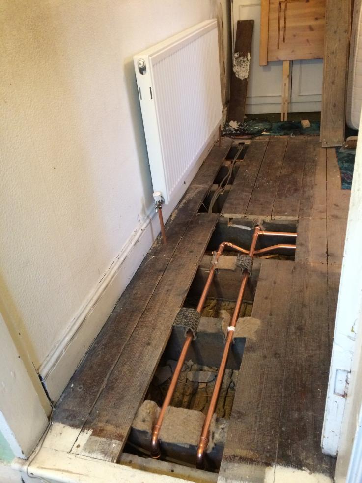

you know, I had forgotten all about this stuff and clip everything where I can or run plastic through a drilled hole in the joists.. but you cant always do that.
where do you get it?
Most plumbers merchants. Just ask for wrap around hair felt lagging.
Yes we used to use it for lagging!!:ciappa:
Wash your mouth out with soap that's a swear word
And any good local suppliers ( we use city plumbing which are PTS , also we use bss)
But don't use the lag stuff use the hair felt strips about 2" wide
Piece of dpm (damp proof membrane) does the job well around pipes where there is little space - especially like drilled holes in joists.
Pipes won't creak on heating if any attempt is made to keep them not jammed tight
That was an 8 pack of hair felt in that first link for £18, - so over £2 a roll.
I used to spend longer double lagging hair felt than it took to install the pipes. Glad to only use it now for stopping creaks. :grin:
