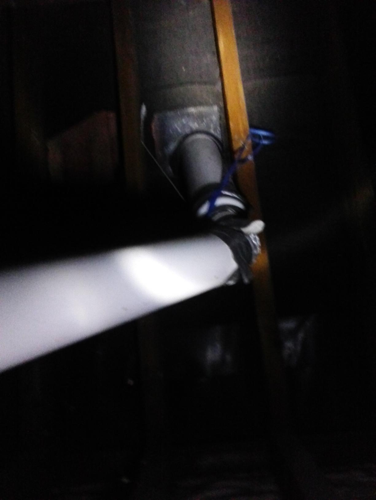

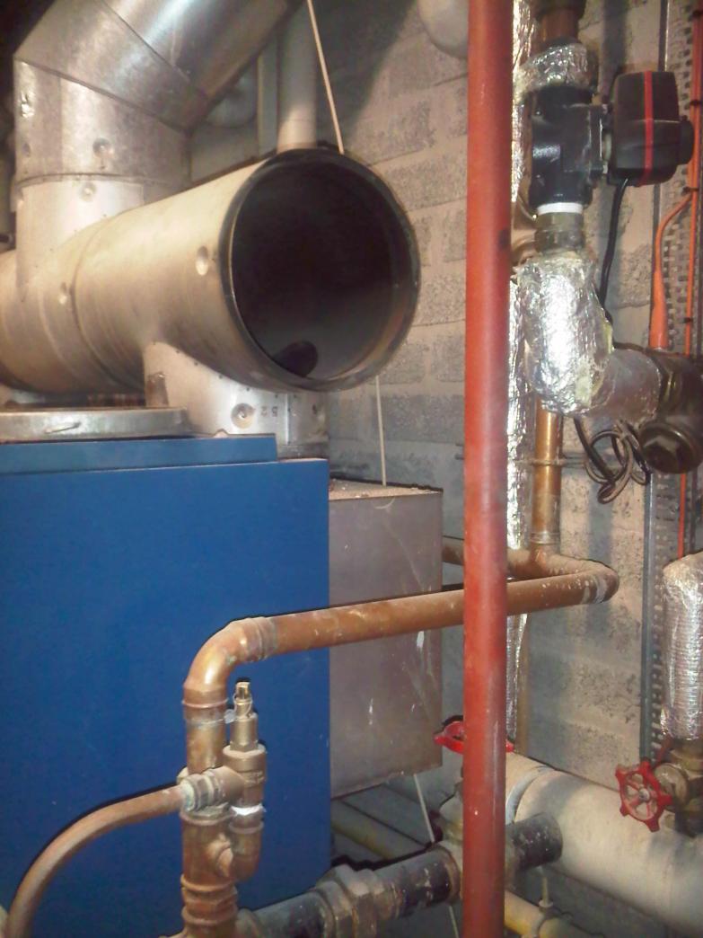

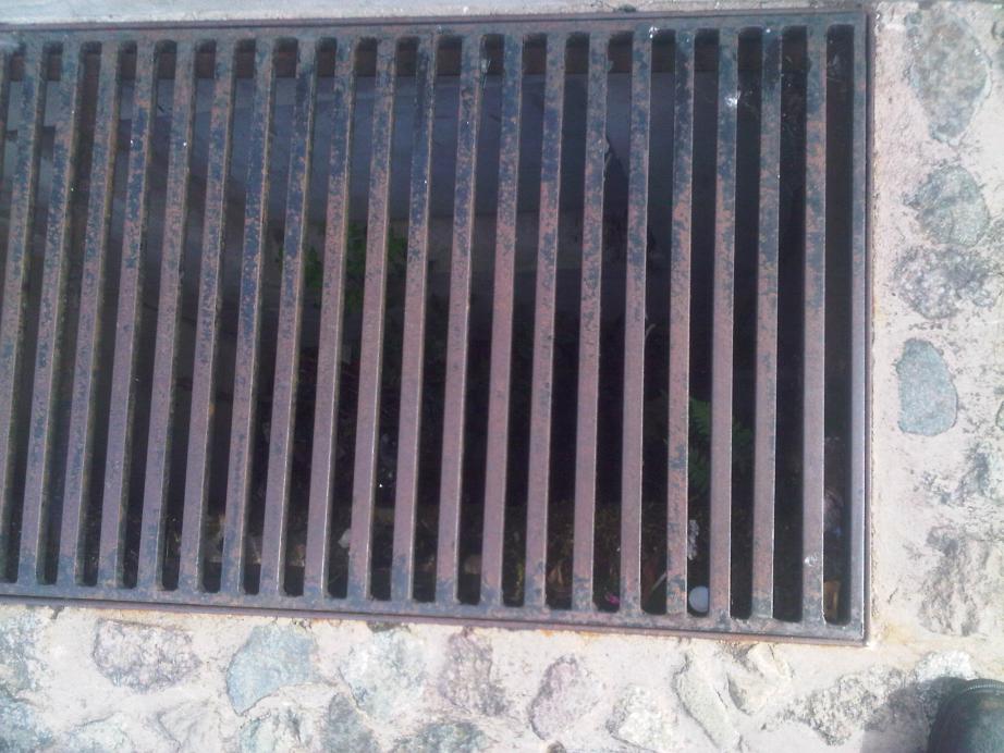

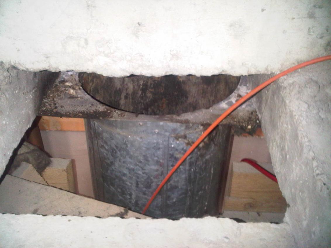

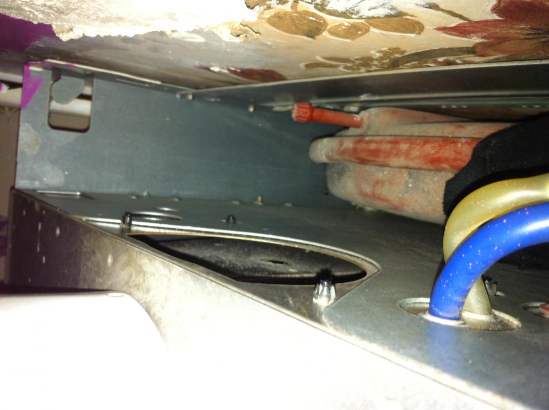

Sorry didn't upload 1st time.
Kids accommodation block in a park sized museum over here. Multiple ID's, AR's and a couple of NCS's. Riddored it. Think the guy from HSE was going to marry me!
Now, afaic recall, flue terminated 4" below the stack in the roofspace above the kids dorms, flue in void with no access panels, end plate missing off flue in boiler house. Boilerhouse was underground on 3 sides and fed by LPG, no gas detection, and the supply air came via 2 rooms and 3 vented doors, breather pipe off the second stage regulator terminated in a large unventilated gully.
I've never knocked off an installation so quick. Rang the HSE chap up and told him to get to me pronto.
He did.

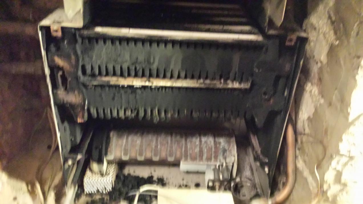

I turned up and fired it up and it worked, chucked my Fga in it as something didn't look right and it shot up and off the scale in a matter of seconds, popped the combustion case off and found a 1" gap between the burner and the heat heat exchanger so when the burner fired up it had flames coming out of the side of the heat exchanger.
