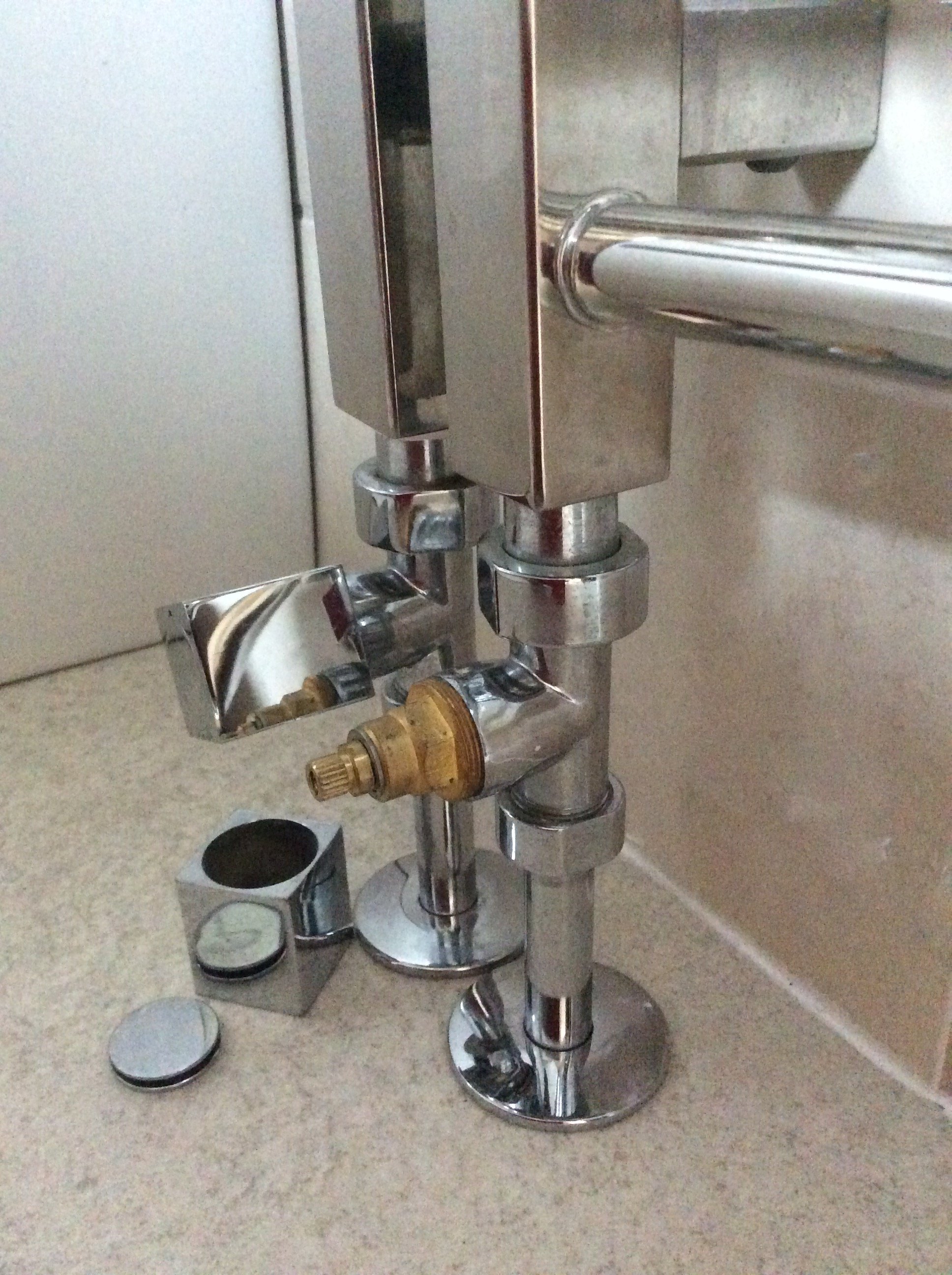

good day folks,
First of all forgive the misuse of terms and part naming.. a little knowledge and internet search is to blame.
I gave a bathroom rad which is cold, which has two manual valves... one of which only turns a quarter turn which I suspect is the reason for the cold rad as it the input valve.
The reason why I suspect the valve is I have an identical setup elsewhere and the valve turns through 360 with ease.
So rather than replace the whole fitting can I replace the valve (spindle/lock shield did warn you about terms...)? And if so where can I get one... is it the same as a tap cartridge?

Sorry to say no you can't just replace the insides to a lockshield valve
If you can post a pic up of the valve and we can tell you which one you need to replace it with

As luck (?) would have it I have the suggested tools, in fact more tools than knowledge!
Hopefully the picture shows enough detail for identification.

I have had loads of towel rail valve seize like yours and have also snapped a couple. (Using to much force to free it. I would say for the price of a set of new valves drain it down and change them.
