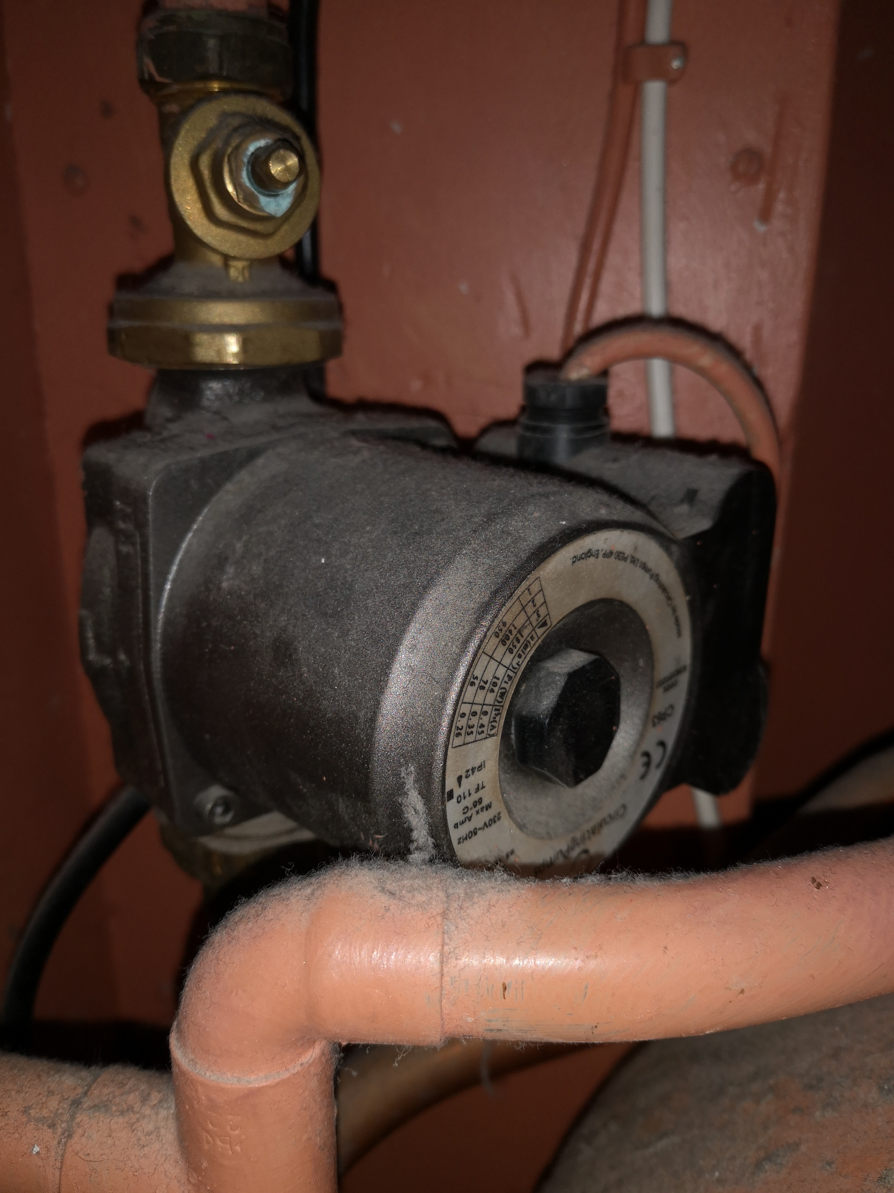

you should be fine wait 10 mins and bleed the pump and any air vents you can see in the airing cupboard (pump needs to be bled working eg on) so do the others first

Good idea! We tried bleeding the pump but never got to the point where water came out. Not sure if we tried too early so we've turned the pump off and we'll try again in half an hour. We already had 2 hot radiators, 2 cold! And 1 warm
On that Myson circulating pump you often need to slacken the black plastic nut and wiggle it a bit to bleed air quickly
