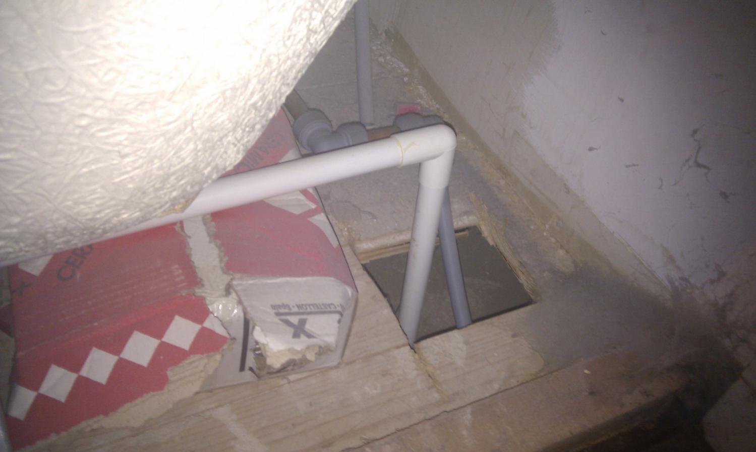

Called out to dripping condensate on a Main, expected to find the usual frozen pipe but on tracing the pipe I found myself in stitches.
Boiler in airing cupboard, condensate runs straight down under the floor towards the bathroom. Note the use of the tiles to prop it up 🙂 Wonder why it never drained away hey 😕
The guy was gas registered and the boiler is "top of the range" according to what he told the home owner.

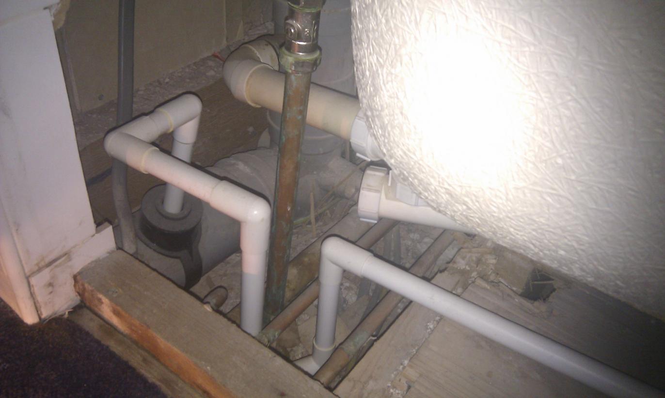

Band B, It's been in for 18 months I believe. The tenant had water come through the ceiling below, which I thought was a blocked soil pipe possibly due to the idiot pushing the condensate too far into the boss as the toilet is to the left of the bath so toilet roll had been catching on the pipe in the boss gradually building up.
The condensate trap was also knackered and the bracket it sits on rusted through. I wrote a report to the letting agent explaining my findings as there were other issues in there also.
I advised fitting a new condensate trap and bracket and re-piping the condensate at a total cost of £140.00 and then billed £40 for my call out. The landlord rang me a couple of days later and I explained it all to her and she said she would get back to me.
A couple of days later I get a email from the letting agent which contained an email the landlord had sent them stating that she called her plumber out who changed a washer on the condensate trap and apparently the condensate pipework is fine. He charged £20.00 and she also stated that I was trying to rip her off and did not want to pay my £40 call out charge.
You gotta love this job at times hey 🙂 I'll wait for the condensate to start dripping again, fall off the rusted bracket and ruin the PCB.
Oh and I also found out that the soil pipe was blocked as they got someone in to rod it after I told them about it.
