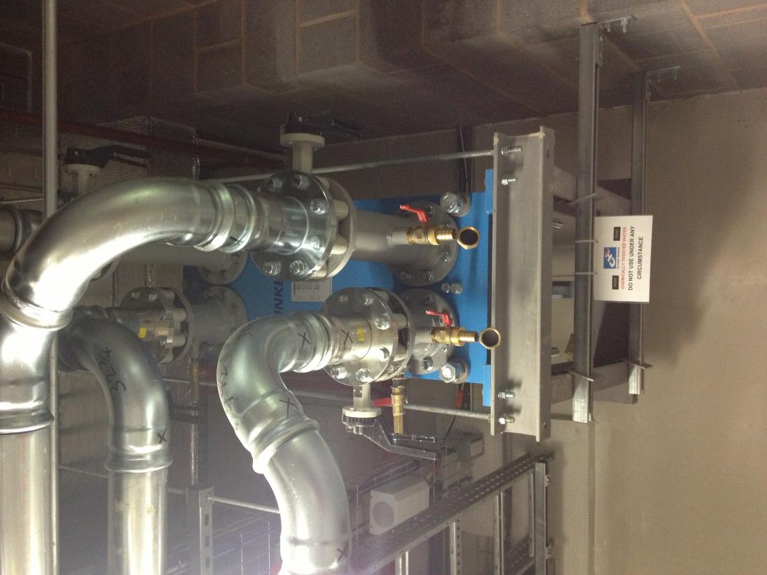

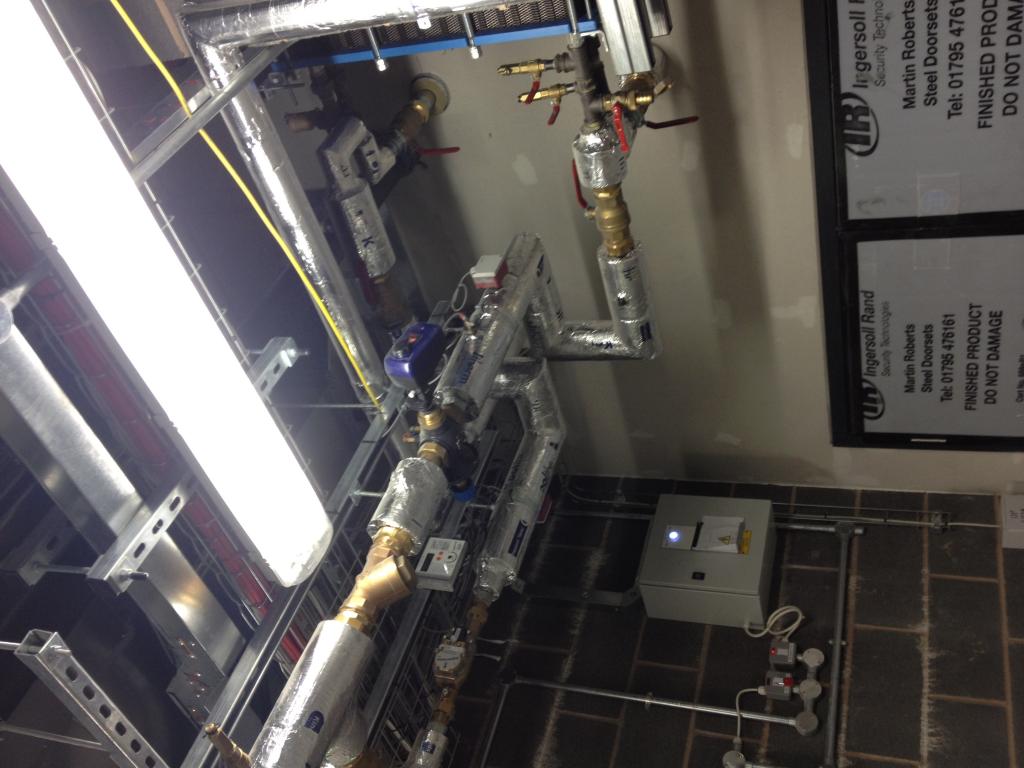

what are the chilled lines for ? What do they chill ? Is it just air con but on larger scale ? I worked on a job in leeds looms same type of stuff ill try and get pics up
image.jpgYou can just about see on the very right wall mounted like a blue box with silver sandwhiched between. They want all these hoovered out etc
The blue boxes are plate heat exchangers.
Chilled pipe work should be lagged and sealed or it will drip with condensation.
Chilled water can be for air handling units to blow cold air or cool machinery etc
I think these are for machinery ! Im debating weather to just hand this to sombody else or just go for it and get my head around it !
