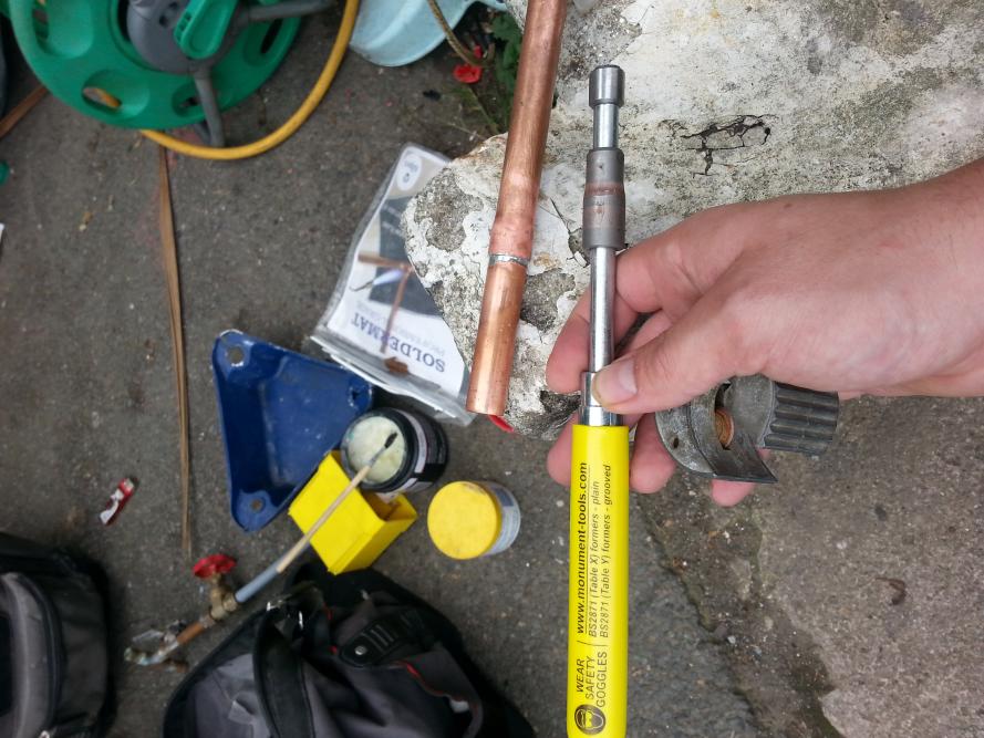

Well this is the 15mm socket former, made by monument, i bought it the other day, yes it does make perfectly good sockets which are watertight, but you need to hammer the former home into the pipe, which can present a difficulty, none the less though it has its uses, may help when your caught short of that fitting, but tbh fittings are not that dear, so i still carry a good selection of fittings.

I have a combined 22/15mm socket former in the van. Dead handy if you're stuck for a fitting. I've had the an apprentice make up some bends including sockets when we were short on one remote job. So I recommend them.

How much do u pay for end feed fitting? And how long does it take to make a socket ? I personally use fittings ( Yorkshire ) but agree that swaging is excellent problem solver, plus u can cone out the end of a 3/4 and inset 22mm. Free metric to imperial adaptor.

I have a rems socket former for 12 15 22 and 28 at times its a lifesaver but if its through the normal working hours I would go and buy a back of sockets personally but for the callouts it can be the difference between leaving a customer with no water or completing the job

I've got the rothenberger socket former. Rarely used unless I need to get a joint on an existing pipe very close to a wall etc. or come across odd sized pipe. It's handy on the thick walled 1/2" copper that nothing fits and is handy for metric to imperial conversions. Only caome out of the land rover a few times a year though.

Socket formers are handy to keep in the van for the just in case but i've probably used a swedger more in the past 10 years.

I was taught at college that these socket formers were against regs as the stretch the pipe leaving it weaker as a joint.
Don't know how much truth is in that. Didn't really have the greatest of confidence in my tutors
