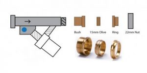

Or fit one of them will boost the flow granted not as much as a 2 bar booster pump but doesn’t require much fitting work
