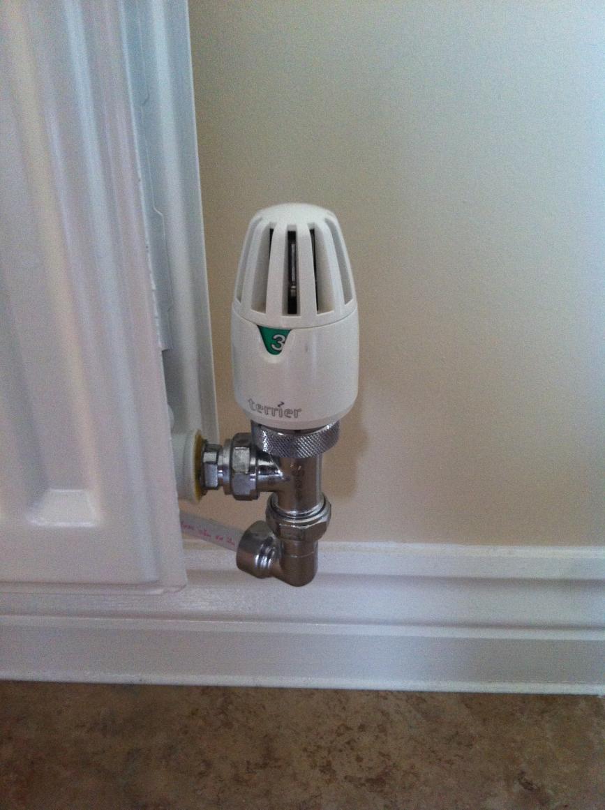

Other radiators in the house are fitted with the usual temperature controlled knobs. For some reason, these can override the settings on the thermostat. Is this normal? If so, it's a bit daft considering when I have to go around the house and switch off all the radiators whenever the thermostat is set to 'off' to stop everything from heating up. Kind of makes having a thermostat useless!
