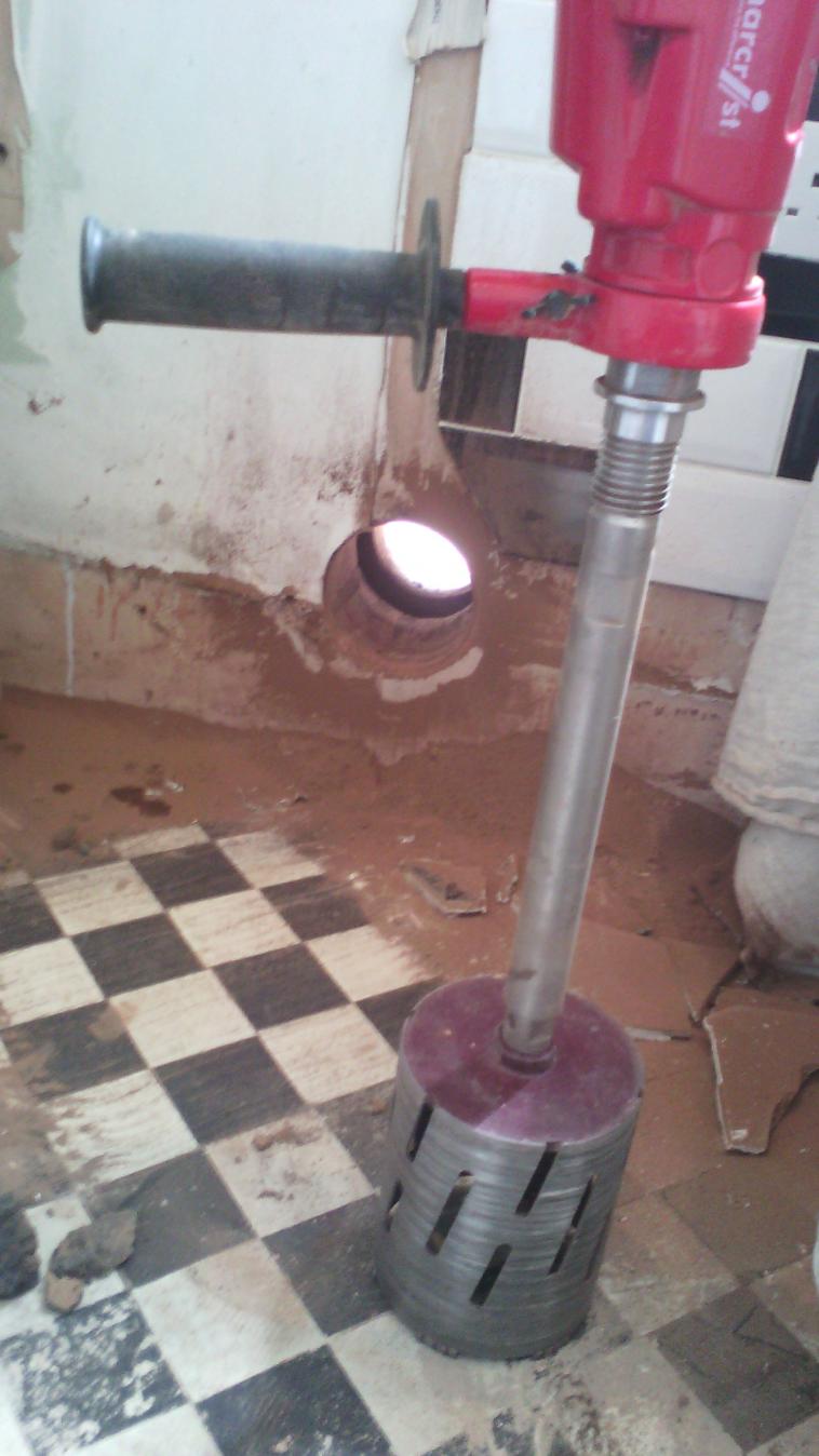

IMG_20160725_130341[1].jpg now i have had the clutch sorted on this,must say its a impressive bit of kit,smashed this 127mm through in 6 mins flat,however as with all core drills its dusty,i could wet core but that would be messy,anyone got the macrist dust extractor and i take it it cant be used with a slotted core?
It's a lovely drill. I have the dust extractor and it works well with my slotted cores.
i had a deal offer had the drill and a 3 core unslotted set,still have a few slotted cores though,does it screw onto the drill and then the extension arm into it?
Aye the dust extractors work fine. You need the solid cores tho.
Screwfix do a set of core bits with an extractor in the box
seen that the other day,could kick myself,should have bought it over the set i got

Ive got a good set up, but way to dusty to use inside a property. I stitch drill it, less dust. And it only takes me ten minutes.
I've yet to find a good extraction set up.

Just can't be dealing of the mess from a core drill

Ive got the Macrist percussion core set (blue) with the extractor adaptor, supposed to use a fancy hoover but I'm a "poor plumber" so I use a Hetty, she sucks plenty and would highly recommend.
Think I got the set from core drill city on line.
I bought the kit about 12/14 yrs ago from hire center (part of plumbs group etc)
Makita 8406 (I think), Marcrist core set and a Marcrist wet/dry hoover with the dust extraction adapter
The hoover still sucks like a **** star and when the adapter is used, it's no more dusty than drilling to hang a rad
