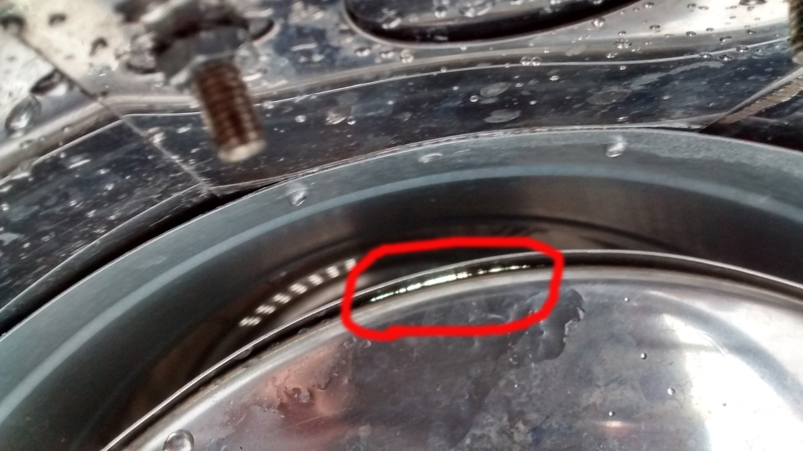

I got asked to do an inspection and report on two faulty Burco lpg water boilers.
The customer bought one from a retailer 9 months ago and it leaked. Tried to take it back and the retailer was having none of it. After much arguing Burco sent out a replacement direct and the ignition doesn't work. Customer is not happy with the quality of the units and has asked for a refund. Burco have said that they can't issue a refund direct but if they take the boilers back to the retailer the retailer will give them a refund. they even gave the customer a reference number for the retailer to quote to get their money back from Burco.

I took the burner assembly out and placed a light source inside the water reservoir and you can clearly see that the seam has failed.
Burco leak 2 by Mike Jackson1, on Flickr
Don't know much about burcho. Are they cheap tat? Looks like a very poor build quality.

Used to be good, now tat. Not so sure about cheap, customer paid over 200 notes.
I'd say the manufacturer can have no arguments. Send them the video and let them know it's about to be put on youtube and sent to Anne Robinson!
