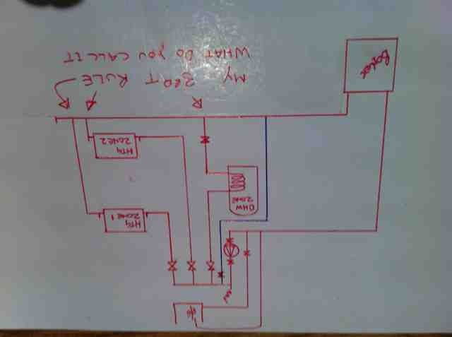

I welcome any comments and feedback to my project I am looking at starting in 2013
now I know all this sort of thing can be done with many of the costly out of the box solutions that probably cost more than the boiler itself
What I am looking at doing is to create a heating system that has at least 3 Zones
I believe I could do this with some changes to the main Pipe work and 3 motorised zone valves and an additional time clock
Reason for project
During the day one member of my family is at home and requires heating to be on for 4 rads in part of the house.
Currently I am heating all the house all day when only part of the house needs to be heated
My daughter-in-law is also at home some times when not at Uni and may need her front room heating.
Now my logic is to have the secondary time clock switching the water flow between parts of the house during the day and in the evenings opening all valves to heat the complete house
Now I know this could also be done with the new wireless digital TVRs but this expense would be significant
I will add to this post as the project develops
If you have any questions or would like to bounce ideas or comments please reply and this may become an interesting post.

thats the easy bit
I don't even see how monitoring the boiler stat would be at all beneficial.
In this case the only thing it will tell you is that you've piped and wired your system up wrong and are producing excessive amounts of heat.
the boiler will require interlock for all zones, to work correctly, meet the building regulations and be efficient. Also dont forget your auto bypass if you didnt plan for one.
good luck and please keep in mind that any work on the boiler that breaks into the combustion chain will need a competent person, this is likey to include the removal of its case.
It may be an idea to involve a Heating Engineer for advise but you seem confident you can get it done. Let us know how it works out.

Good luck OP, but I'd seriously think about each zone having a stat and timer, if you are going to go through all of this cost and effort, it'd make sense to have time AND temperature control on the zones.

And do not. Under any circumstances. Any at all. Attempt to connect into your boiler to remotely control the boiler temp. This is your last line of defence before the limit stat.
Professional BEMS companies know this is not to be tampered with. Take the hint.
well i could install Programmable Thermostatic Radiator Valve Digital TRV on all the rads as these can all be programmed by day to switch each rad on and off each day
But i think this would have a number of disadvantages
1 it will deliver exactly the same result as my project but done at each radiator
2. you have to buy them all
3 set them all
4 change the batterys ever 6 to 12 months
My project will do exactly the same but will use 2 to 3 motor valves to isolate a bank of specific radiators
No batterys or programming loads of TVRs
Had a look at the pipe work tonight and i believe i will need about 50M of 22mm plastic speed fit barrier pipe about £90
Note to other users thinking of doing something similar.
This is not the way to do it, please employ the services of a decent (preferably recommended) plumber/heating engineer.
IMHO
😱 Great another sparky-joiner on the forums......good luck when the 438 throws a certain fault related to flow, directly related to what you are going to try to do!
