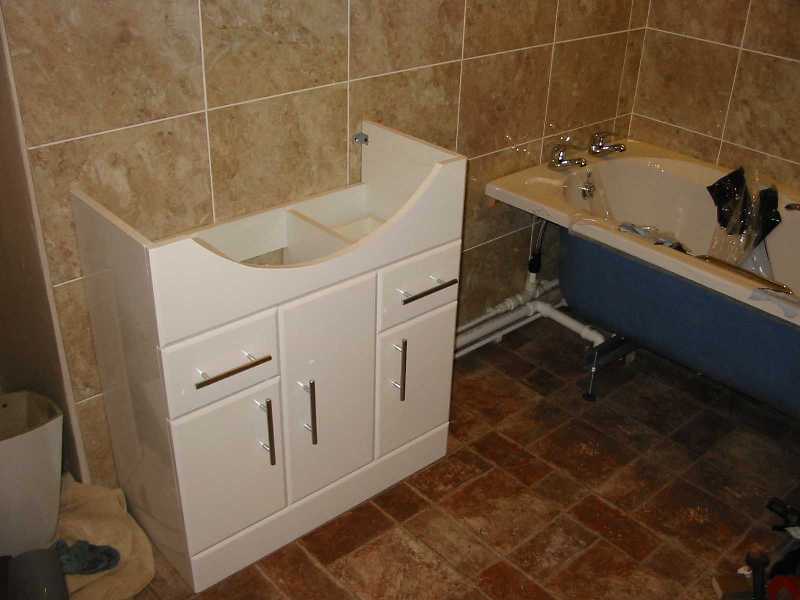

Sorry richard but that pipework is unbelievably rough!!!
That basin waste is sooo high! U wont be able to box that in!!
I wouldnt have any of that in my house.
Sorry just saying what everyone is thinking...
Least you've put a batten underneath the bath for support

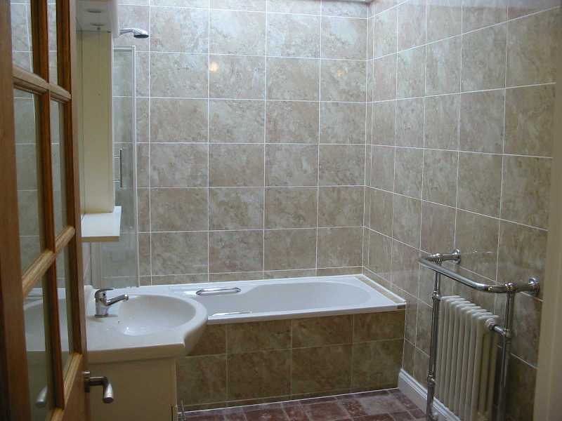

This is the bathroom looks now it is finished
I do not have a picture of the boxing around the waste pipe but it is fine and looks good and does not look out of place.
please follow Ecowarms advise about the wiring and wire it correctly save harming any future engineers. if wired with boiler interlock to all zones and it will save you money and give you good control.

4 elbows on your basin could well bring you problems in the future. Do you have enough access in case you need to take it all apart? Speaking of access - can you get under the bath without smashing the tiled bath panel?
Nice rad though, and keep posting pics Richard. This is my favourite thread of 2013 so far.

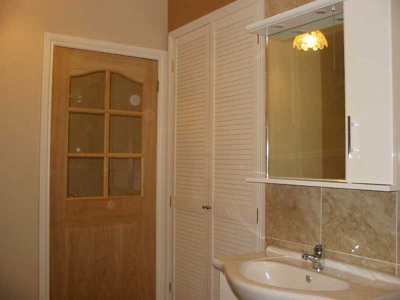

View attachment 9986View attachment 9987
I guess you wanted a feedback on the tiling job, cos you’ve posted the pics for us to see. Here’s one from me. I do tile by the way.
Sorry Richard, not picking the holes but the tilling could be much better. The very first row of the tiles above the bath should sit above the bath lip – not to the side of bath. It would look much neater that way. You would end up with a nice silicone bead. I guess you had to use a plastic strips to fill the gap. Also, the very same row of tiles around the bath should be a full tile. It would look much better that way. I can see the top row by the ceiling would be fuller (which is always good) and you wouldn’t have the first grout line above the wash basing so close to the basin. There would be no issues to do that. Whoever was doing the tiling just didn’t bother to do that.
I don’t really understand why you end up with 3 rows of tiles on your side panel!? What’s the deal with that bottom tile strip by the floor!? Did you run out of the tiles!? A tiller wouldn’t do that. Yes, I can see the grout line on the side panel follows the grout line on the wall. You didn’t have to do that here, cos the side panel ended up looking a bit ugly. I don’t know if you can see that.
As above in the post, you should lose the skirting board.
Good try. I’m giving you 6 out of 10.
And I can’t see much drop at all on your waste pipe work from the wash basin!? It will get clogged up.
Well for a diy tiling job I'd say that's pretty damn good. It's not professional because you didn't measure out correctly first and start from the centre of the walls. Which is why you have smallish cuts at the top and at the end of the walls, and they are not symmetrical at each end . TBH I think people are being a bit picky about the tiling, in all honesty I've seen so called pro's do worse. But those wastes will block.,Get rid of unnecessary knuckles etc and put a proper fall on them. You can read up about falls etc in any good plumbing book. I would suggest you read and absorb several of them before trying to continue with your project. Good luck

never under any circumstances tile in a complete bath panel without access! this becomes so much more imperative when you have used plastic pipe and flexible tap connectors behind the panel.
but im sure im worrying about nothing....as an engineer im sure you will have thought of this and no doubt built an access hatch into the other side of the wall from the bath taps, and cunningly disguised it with a floor standing cupboard.
Thanks Guys for the feedback
There is more fall on the pipe from the sink waste that than can been seen in the picture so i think this will be ok, No problems so far 12 months
The bath panel is removable and is only secured by a bead of silicone and magnets on the back so i can remove it if needed
I have added a pic of the tiles and the ceiling how its finished.
Also a pic of the toilet as requested, Roding point inside the cupboard for building inspector
This complete panel behind the toilet is also removable you can see the clearance gaps. I have sealed these gaps post this picture with white silicone to neaten the finish it and it now visually looks like the bath panel
I am not a tiler and i know my job is just average but it looks ok and is functional
It is just the spare bathroom in the annex
