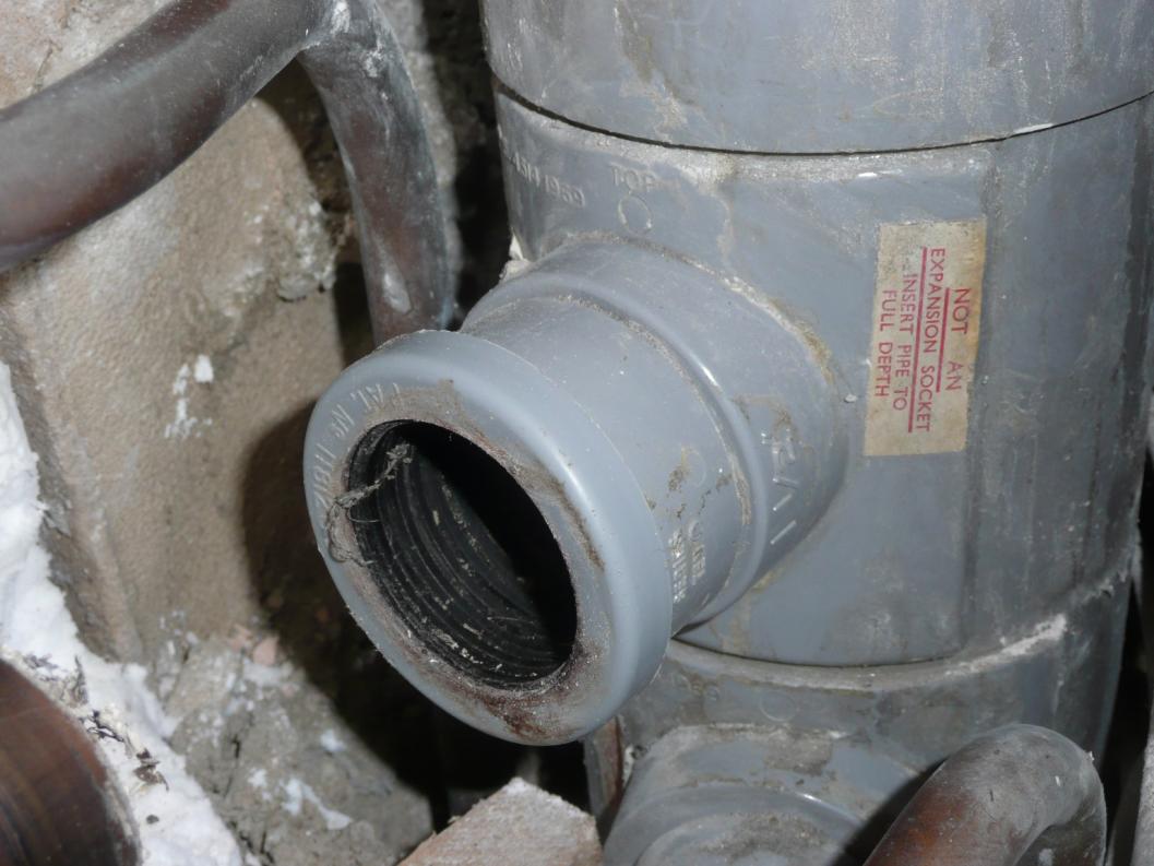

  • Run it into an existing 30 year old push-fit boss, which looks in reasonable nick apart from a greasy residue around the old push-fit seal – not sure if this old plumbers grease or an oozing joint. This would give the shower a dedicated access to the stack, but I am concerned about that greasy residue and long term reliability. And I would need to connect push fit pipe to solvent pipe with a compression fitting. All this then buried under floor beneath the shower. For obvious reasons I would prefer a solvent weld solution.

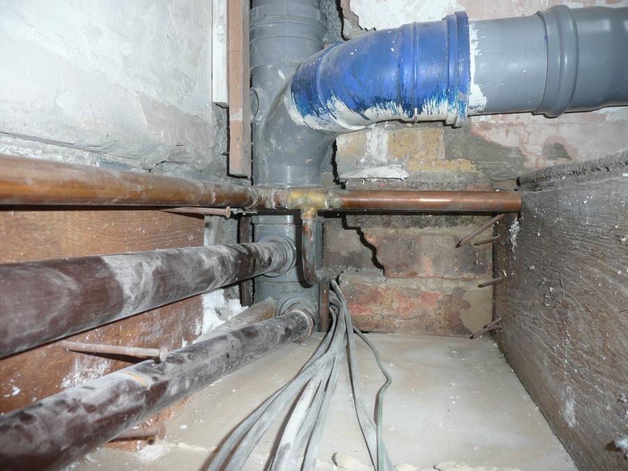

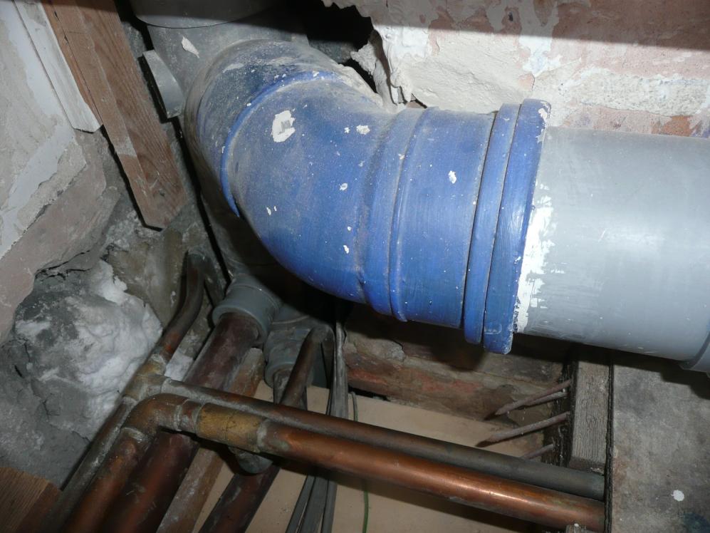

I was trying not to go into too much detail, but perhaps pics will help. Not sure if I've uploaded properly.
- The soil pipe is in a narrow recess in a cavity wall. I don't think there's enough width for a manifold.
- No room for an extra boss either. As you can see soil is above floor. The 40mm referred to above is in the void (top one). There's also a 32mm boss in the void, which I didn't mention before, which I plan to block off. The new 50mm boss will be below the ceiling in the downstairs loo, with 50mm pipe coming up through ceiling approx 1 metre from stack

Above the room is a sloping roof and sloping ceiling (ie no workable loft space).
Below the room at the stack end is the downstairs loo, which extends 1.2m towards the camera in pic 1. Hence the plan to put the 50mm boss into the stack in the downstairs loo, ie just below the 32mm boss visible in the pic. The 50mm pipe will then come up through the ceiling somewhere within that 1.2m and continue in the floor-ceiling void towards the bath which will be behind the camera position.

I am nervous of doing that much surgery on the stack in that corner. If you look at pic 2 you will see it's a busy corner. The copper pipes would need moving, and are notched into 7 or 8 joists along the room. Below ceiling level they also obstruct the stack pipe for cutting. Then there's that bunch of cables ... I think it's important us DIY guys know when we've reached our limits, and I think that's beyond mine.
