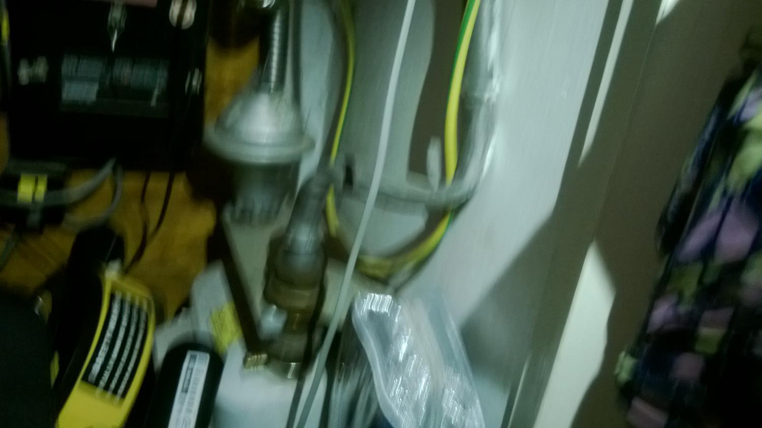

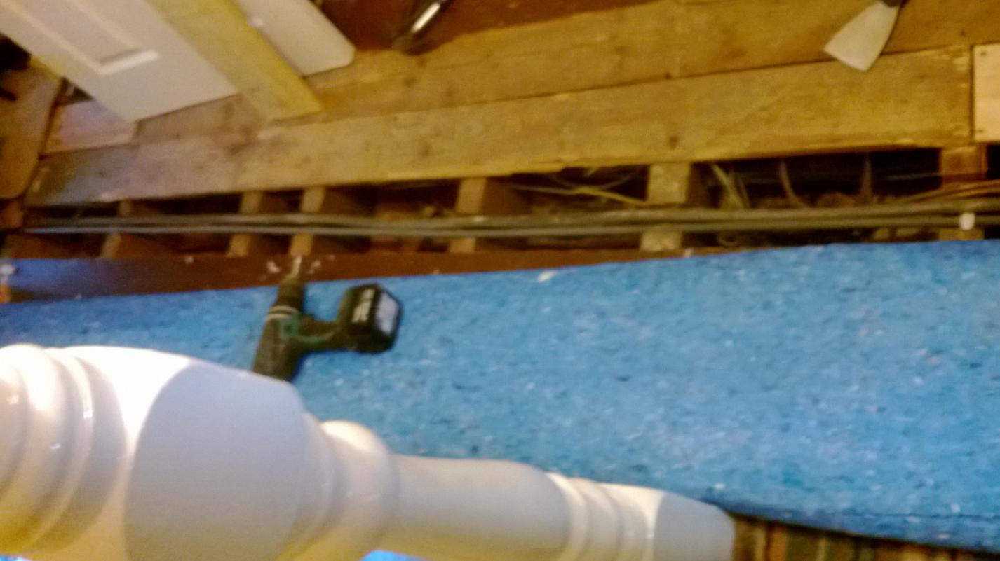

yea looks like it bunch of rough *******s boiler fitted by BG 4 years ago a ideal isar 30 kw and serviced by them since in total with resistances its a 70 ft gas run a 30 kw combi a 31 kw double gas oven range with 8 burners and 2 gas fires roughly 75 kw being fed through 3/4 lead with a internal diameter of 15mm pipe note the kinked lead at the meter,they even asked BG why the gas cooker extinguished when the boiler was providing hot water BG told them cooker was faulty,they lost faith in BG after the isar they provided kept breaking down but a lockout fault was always a issue bet it was the gas supply anyway some pics while i fill out the RIDDOR,and yes that is lead under the floor boards

On a more serious note, that is terrible by BG. I had one a couple years back where a new 30cdi system boiler had been fitted by BG, off the gas meter in old lead pipe for about 3 meters all bent and crushed. Getting 10mb at the boiler on max, who in there right mind would leave that as it is. I was there to fit a cooker and refused until they agreed I could replace the lead pipe.
no phones cameras hard to keep steady and take close up pics because of the plastic case that protects it ,next person to mention the pics gets bit by croppie,and croppie will bite whatever he can reach
