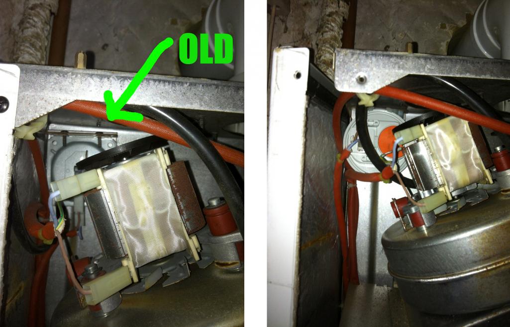

the problem i have is when fitting the wiring i keep pushing it off the clip - quite easy with the side panel off though
Yeah I took the side panel off. No way I could do it without. I'll get the pics loaded up now.

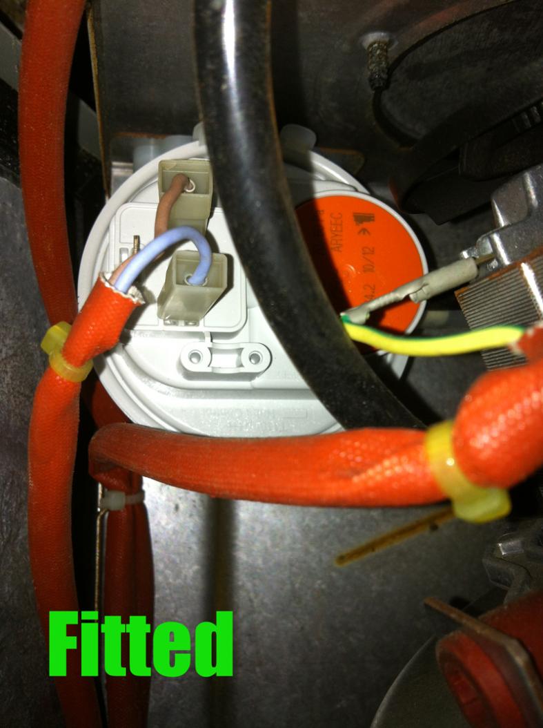

Well I promised you photo's so here you go!!

That's a mains boiler, the baxi,s have two sensing tubes and three aps wires. A tip if your stuck for room at the side to take panel off, take the fan out.
2 tubes on all variants 24kw has 2 wires 30 has 3 wires be it baxi,potterton or main
There's only one tube Going into the Venturi, where does the other one go?
I would have taken the fan out if I'd had to, luckilly with the side panel off it was very straight forward.

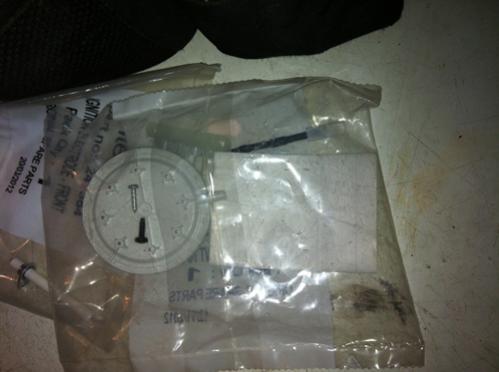

I tested the old APS.
The C to NC wasn't working when I blew into it, or it may have been the C to NO wasn't breaking. Anyway it had an issue, but not one that I can see would have affected the boiler, as it was the wrong terminal (if that makes sense!!!!)
basically the honeywell aps gets too hot behind the fan after it was relocated when the boilers became HE the diaphragm in the switch gets overheated and eventually sticks and fails

The green centre of the APS did look a little heat damaged, and like I say either the NO wasnt breaking or the NC wasn't making I can't remember so it def' had an issue.
out the back of the combustion box,the airflow through the aps has to go somewhere but its plugged so just a small amount travels down the tube

thats whwere i struggled i tried to screw the new plstic clip through the top of the boiler and when holding the aps it kept coming of the clip never thought of fitting it to the old brkt.did you do it without moving things out of the way
