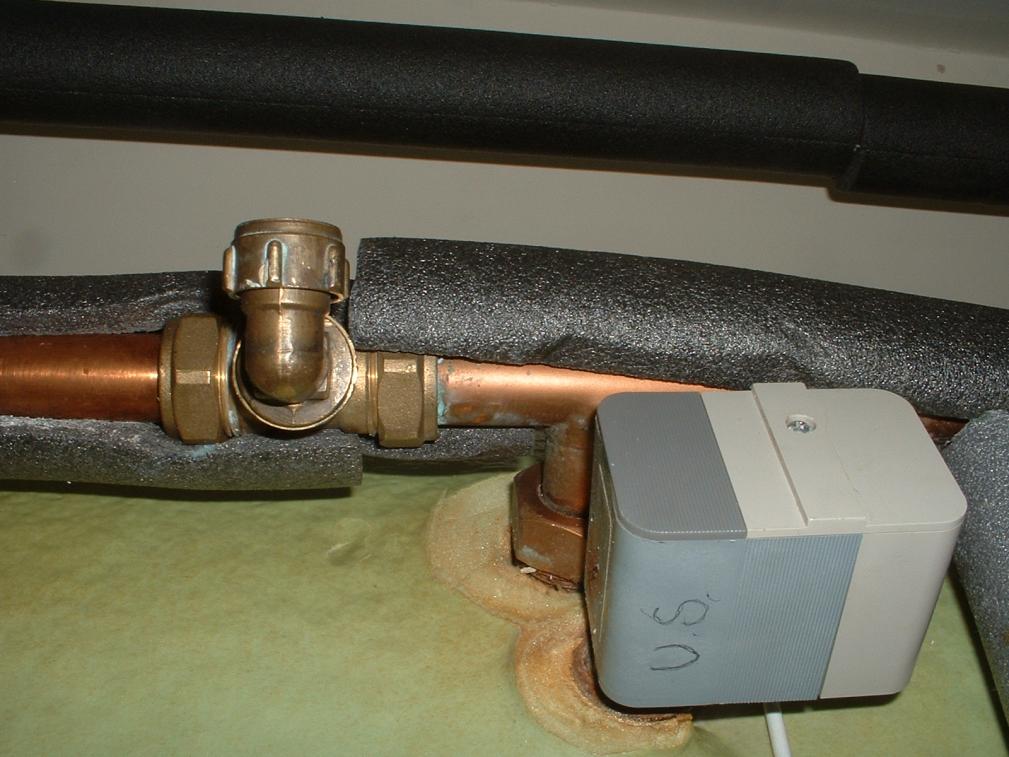

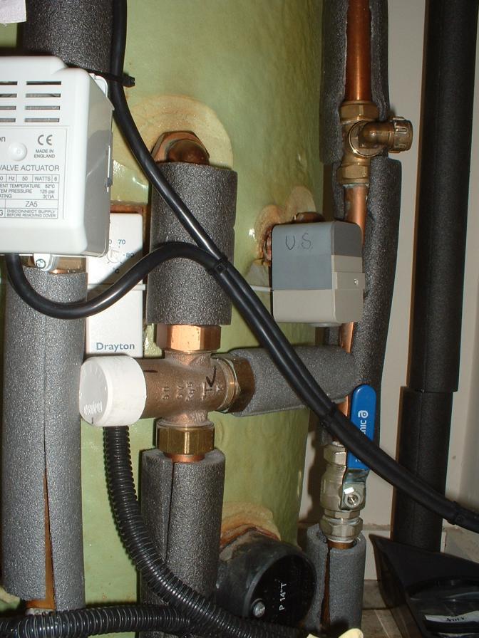

I am attaching two photographs which I hope will be helpful. I've removed the defective expansion vessel and temporarily stopped up the hole with tap connector elbow, as you can see. I would appreciate your further comments as to whether or not I should fit a new expansion vessel. Thanks in anticipation.
Regards.
