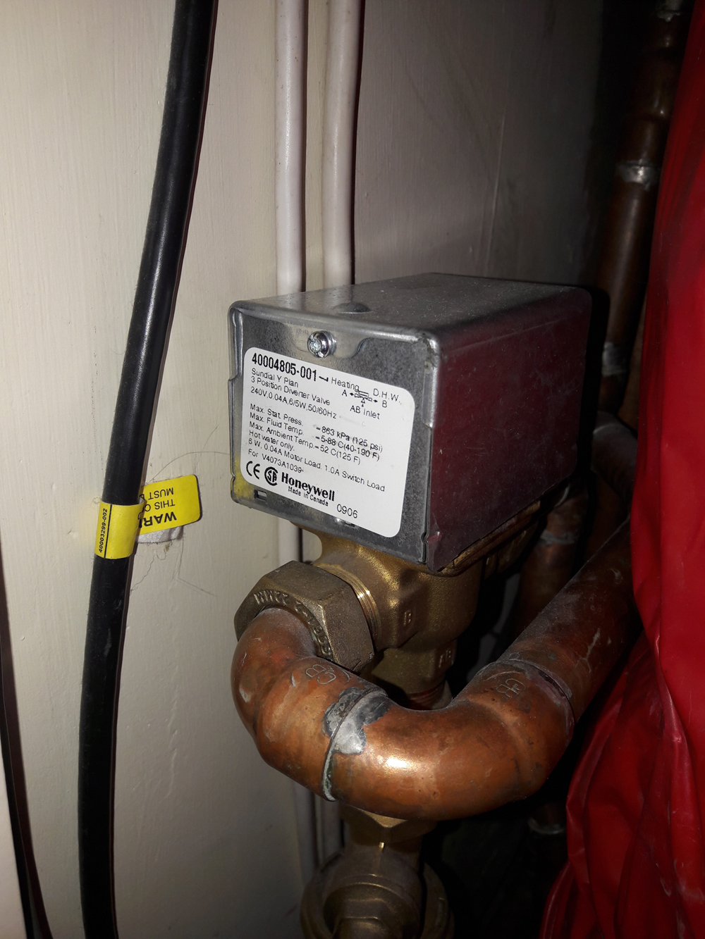

Hi Gasmk1, not sure which valve you mean. This is the motor.
No the silver box above the pump on the end you can't see is a lever if the lever is floppy when there is a heat demand its opening and either not making the switch so nothing works but if the lever is stiff and you feel resistance when you push it then the valve is faulty. You will only be able to check properly if there is a demand for heat
Hi Gasmk1, thank you so much once again for your reply. Ok so this is the valve I take it (picture attached)? I pressed the heating button on the boiler and felt the lever on the back of the valve, and it was not stiff as far as I could tell. I could move it left and right. Which position should it be in?
if you have a call for heat then it should just be loose if nothing happening then its most probably the pump but it could be the valve not making its switch. you will need either a gas safe engineer or someone with good electrical knowledge to look at it

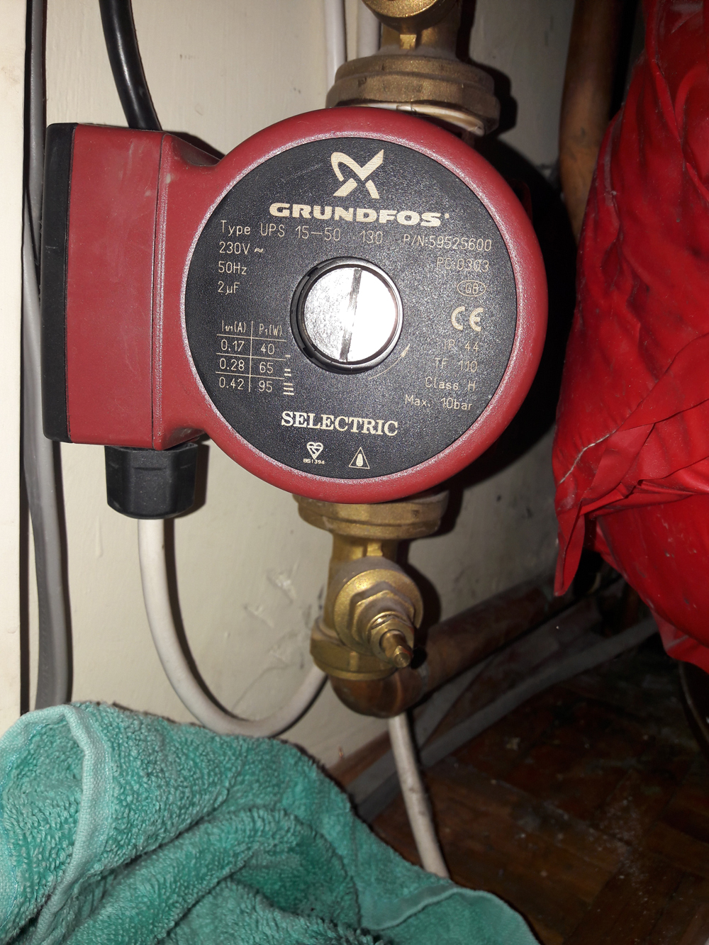

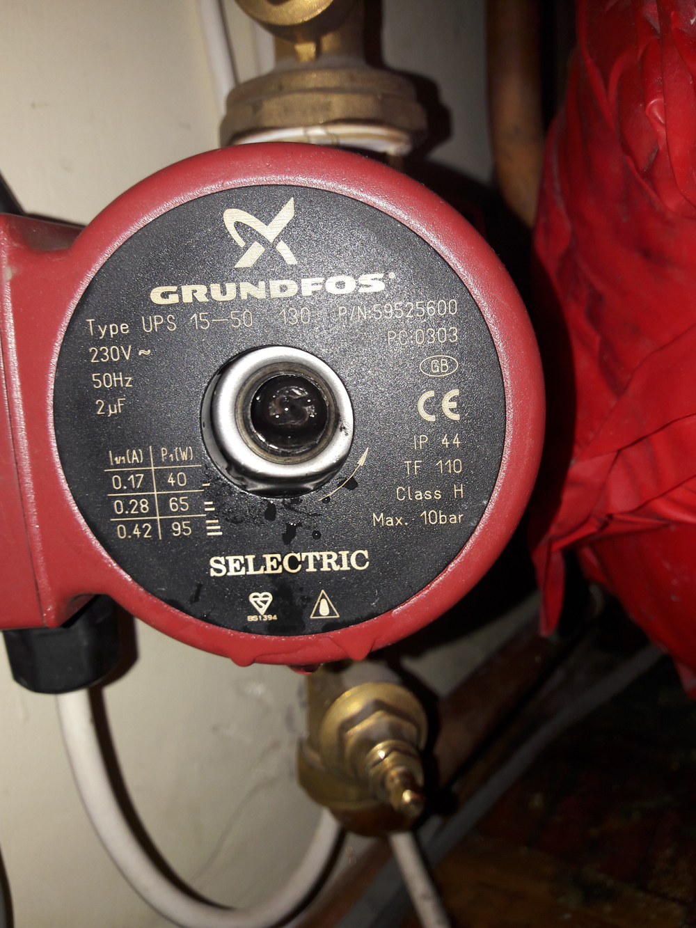

I switched the electric to the boiler off and removed the screw on the front of the pump (see attached photo). But with a screw driver I couldn't turn the screw inside. Does that mean the pump has seized up? And if so do I need a new pump? Thanks
Thank you again Gasmk1. I tried again to turn it and free it up but it seems to be stuck/seized up really tight! Won't budge at all.

Thanks for your reply Dan. I found a youtube video of the exact same pump (same 59525600 part number) -
And it shows it easily spinning. Mine does not budge at all.
Update: I removed the screw on the front of the pump again, and the screw inside still would not budge. So I used the screwdriver and a small hammer and tapped a few times. I could feel it was moving a little, then I put the screwdriver in the center and I was able to move it more. I then put the central heating on and turned the screwdriver a couple of times and I could feel the motor going. I then put the outer screw back on.
The heating has been working for the last hour or so and I have hot water and heating again (for now anyway!). Thank you again everyone so much for your help!
What do you recommend I do now? Should I consider replacing the pump, or leave it. How long is the pump likely to last? The central heating system was installed around 7 years ago.
