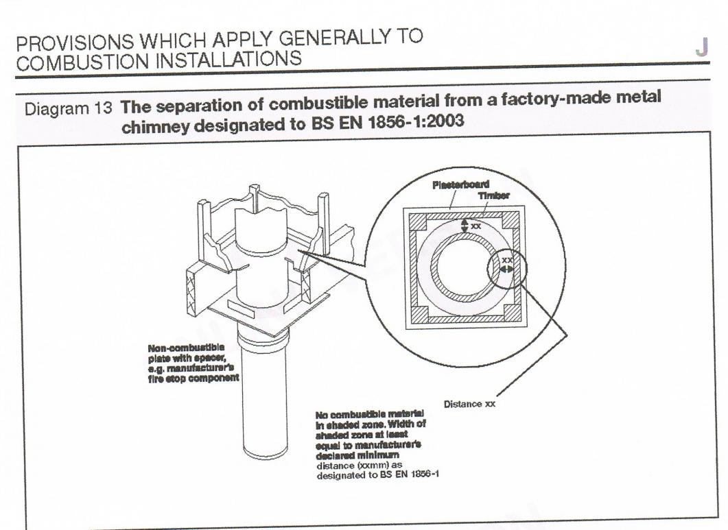

Building regs part b2 covers internal fire spread but i dont think you will find any specific details reguarding fire stops. I do know that any firestop must be fixed to ensure its fixings wont fail before itself in the event of a fire, what good is a fire stop if it falls out due to poor fixings?
the above is from part j of the building regs, i think as with anything else manufactures guidelines should be followed if available.

Assuming the ceiling is plaster board then it should have a min fire rate of 1/2 hour, building regs require you to make good to keep this fire rating level. The plastic collar is not good enough for this purpose unless the manufacture has tested it.
ah, so if i make the gap good with intumescent sealant and refit the rubber collar then i should be ok ???
personally i would fit a fire guard, you have to have the 25mm gap to plasterboard anyway so a sealent would struggle anyway.
