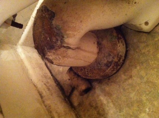

Hello all, I have just moved and am the proud owner of a downstairs WC with concrete floro - vertical soil pip - direct connection with a large collar. The existing WC is a low level type and i wold like to replace with a back to wall type.
The BTW pan has a horizontal exit - which i assume I can get a simple 90degree pipe to connect to the existing?
My query is (without me first ripping out the WC which is our only one in the house), is it a case that i remove the existing pan and the 90degree soil will fit in the existing collar , or do i have to cut the collar fit new soil?
Attached a picture (excuse the grime)...
cheers
rob
depends on the soil distance from the wall (looks quite good) different waste fittings will give some flexibility but you might need to build out behind the wc to make it work
Thanks for the response - building out won't be a problem as I had planned to build out anyway for the concealed cistern.The distance to centre of pipe is 250mm from the wall, my main worry is I don't know what to do with the collar - do I remove? If so what do I replace it with? Cheers
I think you should just bung in the new pan connector and fill the gap with sand and cement, but I might stand corrected before long.
That'll work fine, I tend to remove the collar (careful the bits don't drop down the whole, wedge a cloth down to catch it) with the grinder and then angled pan connector or flexi pan connector.
