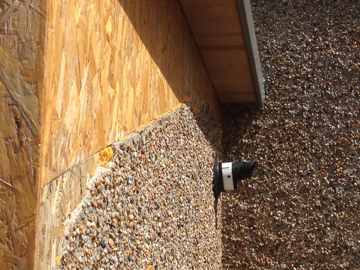

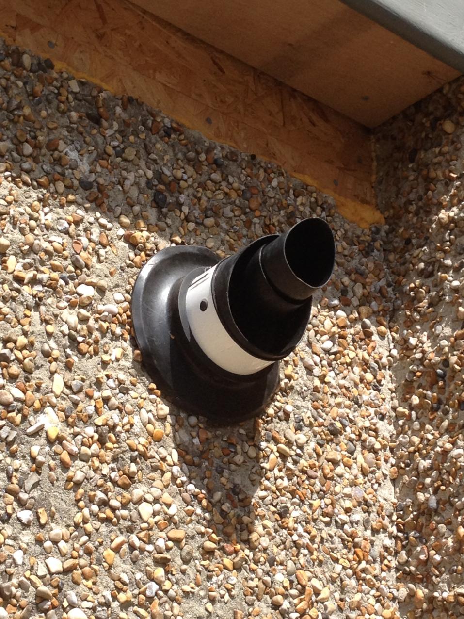

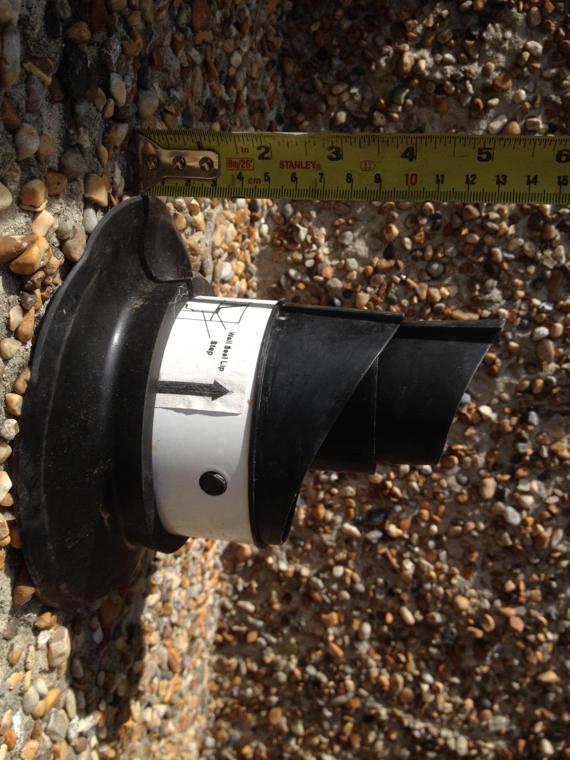

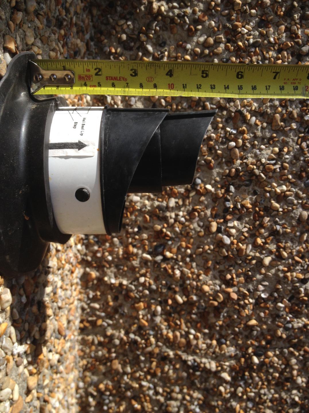

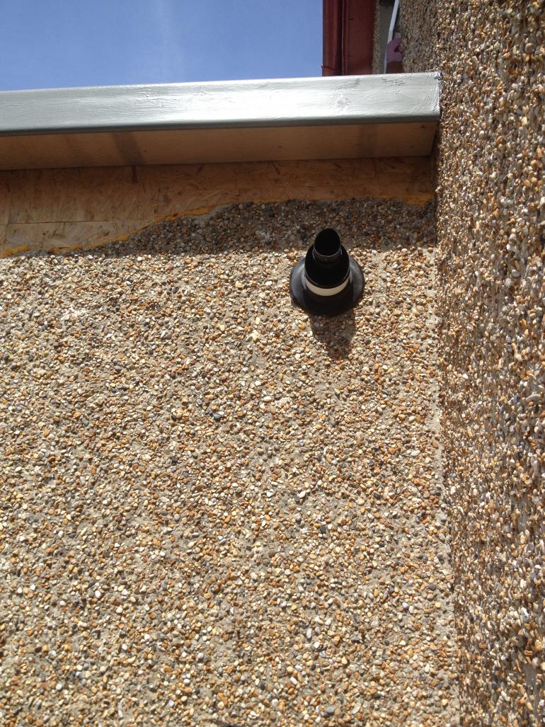

First off I am not a plumber or heating engineer and have no intention of touching any part of the boiler. the boiler was recently installed by a local gas safe registered plumber. On the day I reminded him that this wall is to have external wall insulation applied to it - so 50mm of rigid insulation plus a thin coat render - around 60mm in total. I asked him to allow 50-60mm when fitting the flue and the 15mm copper vent pipe in the pictures. It's probably wrong of me to question it but I recognise how getting this wrong could potentially make the boiler unsafe and the EWI firm can't be expected to know. From the photos can anyone say whether it looks right? ie. if the flue and pipe become shortened by 50-60mm because of the wall insulation will they still project the correct amount?

Thanks APP. When you say a bit short - is it marginal would you guess - or clearly too short!
Is the external render being removed or insulated straight over?.
With the render being rough cast there is easy 15mm there if it is being removed thus flue length maybe ok but tight.
If insulation going straight over render then will need new flue fitting post insulation installation to correct measurements unless telescopic flue originally fitted where upon he may be able to adjust to comply with regs.
This is always the problem when trying to pre-empt other work when other variables outside your control can have an effect on your work.
I'm sure if you had a chat with him it will be easily resolved post insulation fitment,

Hi Andy. Thank you. The rough cast is staying. So as you say I will need to ask him to look at it and as you suggest it may be best to do that once the ewi is done.
