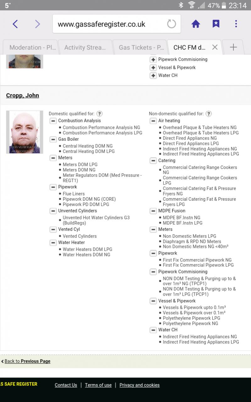

so there being forced to really in some ways or another haha, good for you commercial guys then. If I do my change over to commercial catering and do Comcat 1-5 then that should cover me for a large portion of small commercial business to begin with won't it, better money aswel compared to the domestic side from what I've been reading
More than I thought actually, would have to change over for heating and laundry aswel and everything else associated with them then I take it
