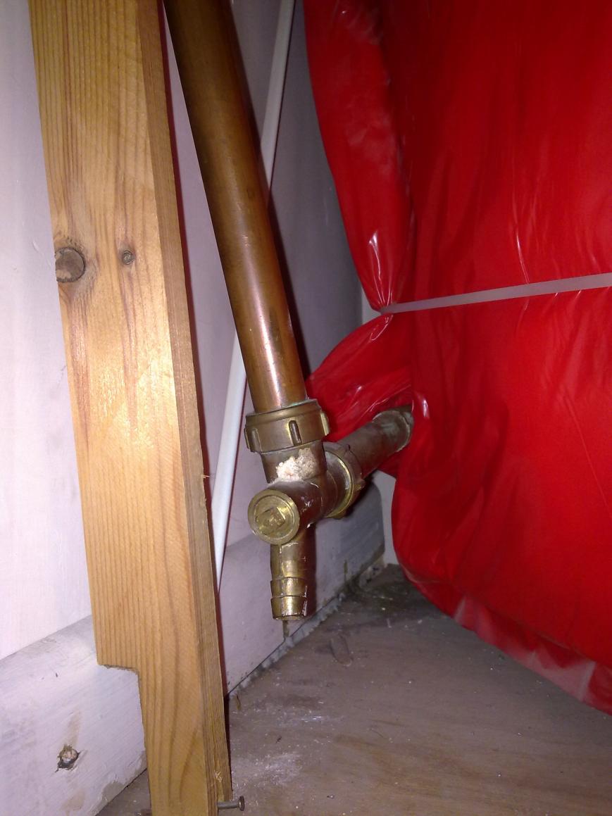

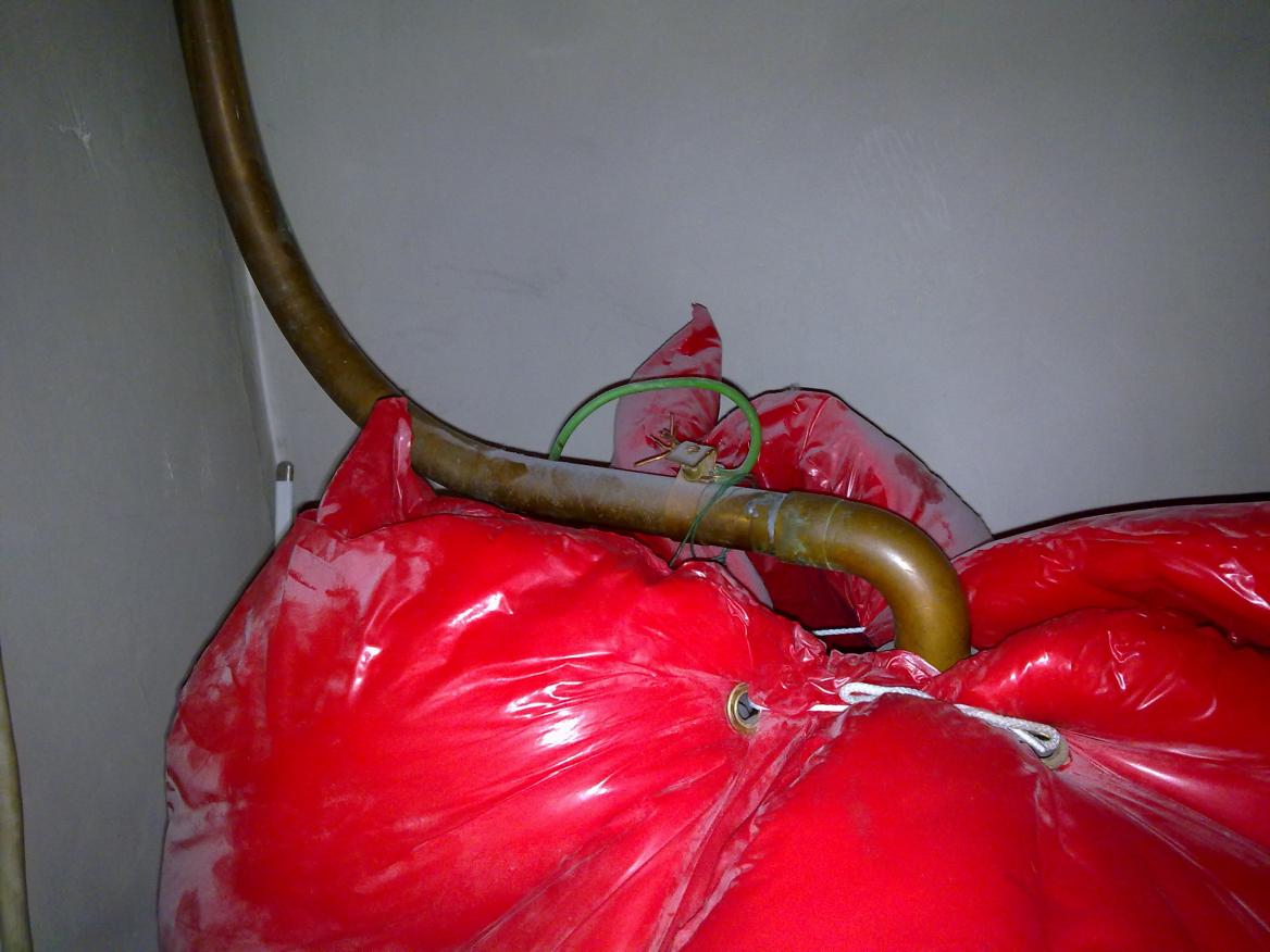

The first pic is the pipe at the bottom of the cylinder and the second is the one at the top, but cant see a blled valve.
Hmm!
Those pipes really have nothing to do with heating the water. One appears to be the vent pipe and the other the cold feed.
You should have if its a conventional system two other pipes going into the side of the cylinder known as, Primary pipes, Circulating pipes or Flow and Return. The flow being the top. But you don't seem to show any those pipes in your pictures.
The actual cylinder can be either direct, indirect or prismatic all of which work slightly different. Your bathroom rad could be on the main central heating circuit or the hot water heating supply circuit.

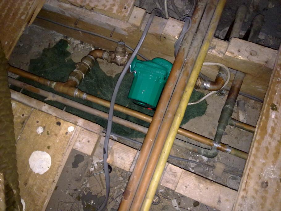

The pipe after the pump goes 'as far as I can see to a Rad in the same room, will attach a pic now of the pump.
k.
The 2 long pipes above the pump normally are hot (but now cold), as these go to the cylinder in the airing cuboard, the pump direction is 'left' and as far as I can see left no valve, would this be on the joint with the rad it goes to?

It looks like gravity hw pumped heating to me mate, you could pull the stat out the boiler and try to boil the air out of the circs, but I wouldn't try it unlessyou know what ur doing pal.
