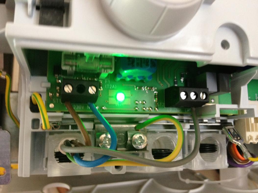

I see more of these boilers wired incorrectly than any other, especially when it's been a 3 wire heat only boiler, ideal classic etc.....
Bit like this then ...
Lol thats half decent, it has a perminant live, the ones I see do have a E & N as you would expect and SL into LR! So no pump overrun or blue led, more importantly when a perminant live is not present the gas valve solenoid safety integrety test is not carried out correctly!
