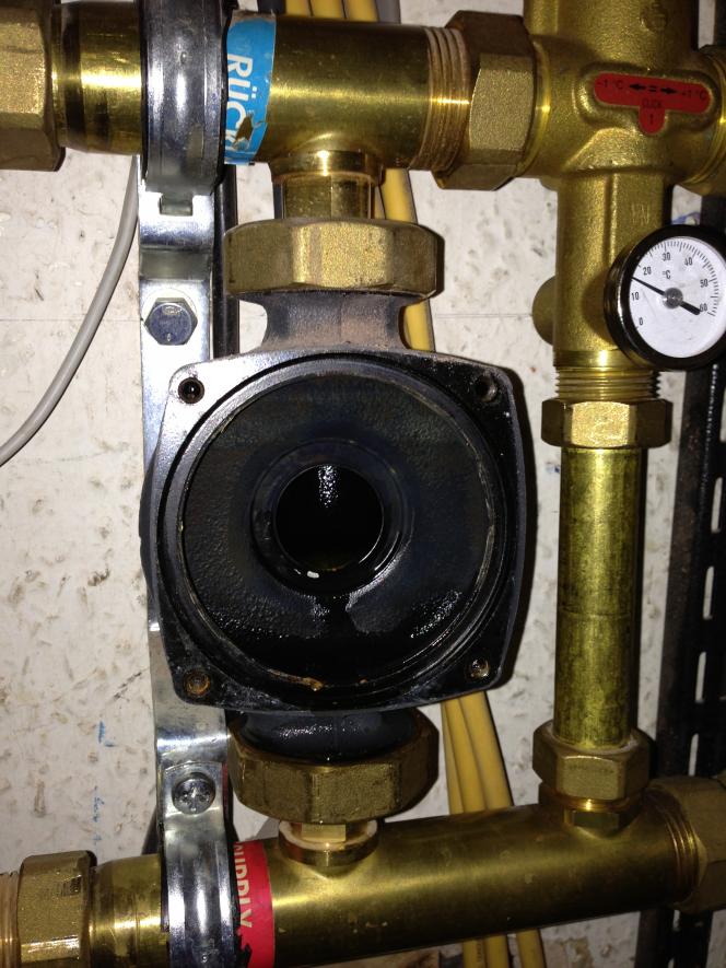

Thanks for all the info guys but are you saying a Grundfos Alpha2 L 15/60 130 will do the job or shall I hold out for the Alpha 2 L 25/60 130. Having spoke to a couple of distributors today they are telling me the pump is unavailable (25/60 130) only available to OEM....Sounds crazy!
Thanks for all the help but talk of pump curves etc and BS / En standards is all abit over my head. Can I fit the 15/60 130 pump head onto the existing 25/60 130 pump base?
The pump body has 1.5" connections, all I can see is the 15/60 130's with 1" bodies. Also it appears as though the Alpha 2L 25/60 130 is only 22watt not the 45watt of the Alpha 2 25/60 130. Have spoken to Grundfos today and they are saying they can't help "go back to the OEM" Polypipe the OEM are saying the Alpha 2 15/60 will fit. I'm saying if the Alpha 2 15/60 does not have 1.5" connection then it will not fit. Can anybody make sense of the whole situation.

Have a run over to your next PlumbCenter/Grahams/CityPlumbing/... and ask them for the price of a Alpa 2L 15/60. Surely they will be able too to show you the required pump valve too and should it be 1" then please post the parts number for it here just in case one of us would come across the need of it one day.
DirksPlumbing, I did as you suggested and the 15/60 has the 1.5" connections. Thanks for your input and problem solved, why Grundfos make it so hard to gain literature I never know.
