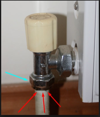

Hi all,
This is in no way a blame thread for the recent work I have had done as the guys were top notch, just looking for a bit of advice on a few puzzling questions I have since.
I had a power flush done as two of my 12 radiators were not getting hot in anyway even though the flow pipes were red hot. The flush fixed this but we also had to have the water pump changed also at the same time as it was on its way out.
Since the flush and pump change the system does seem a lot better but:
1) Now 2 radiators (not the same ones that used to be stone cold) seem to have a hissing sound coming from them TRV side. If I turn the TRV up or down just a little this noise goes away but does return a while later.
2) It sounds to me like there is a rushing water sound coming from most of the radiators...this is not loud but I cant recall it being there before.
3) I have bled the upstairs radiators a few times since the work 2 weeks ago and each time I have had air or gas coming out of 3 of them.
4) On one radiator the pipe leading to the lock shield valve started leaking which I then tightened up (blue arrow) but not sure if this was due to pressure or the clean by the flush. Picture below showing where it was leaking from:
**I think during the work the flow and return sides of the radiators have swapped (not sure how this could have happened) as I am sure they were opposite sides before. From my knowledge the all the TRVs are multi directional though.**

Trv rad valves often make that noise when they begin to close especially the cheaper brands , your system is alot cleaner now with a new pump fitted so the flow rate through the system should have been improved this can possibly make the system seem noisier providing your engineers vented correctly and added a good quality inhibitor the system should settle down , any leaks need attention the radiators which seem sluggish turn off all the rads that do work vent any air fire up again and let the pump move any air trapped until they get hot you may find speed 2 is sufficient once the air is removed . Cheers Kop

Only if they reversed the pump direction for some reason? Did they?
Open Vented, tanks in loft, hot water cylinder in airing cupboard along with new water pump (set on 3).
I'd try turning the pump down to setting 2. You have a similar system to me, I have 13 rads and it's totally silent on setting 2 but setting 3 introduces a slight noise.
