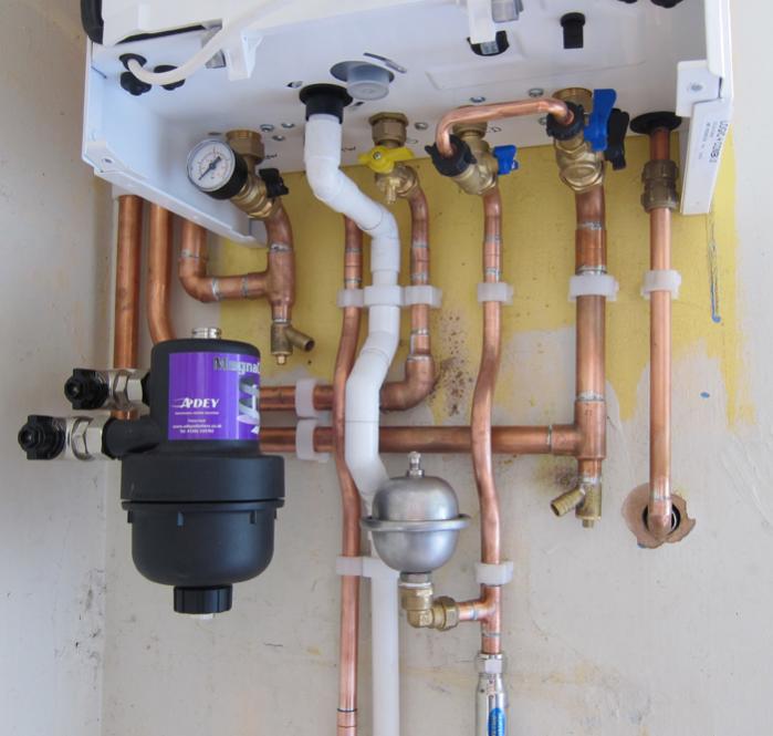

The mark next to the 22 elbow was there before.

All done, should get paid tomorrow. Another Logic is on the wall, supplied by the best plumbing merchant on the south coast - Williams & Co Ltd.
Plastic block?
Water section manifold. Glowworm call it the sanitary block often referred to as the hydroblock or similar. Worcestors are plastic nowadays as are Glowworm and I beleive the new logics. Without the mini expansion vessel the plastic tends to warp/split and **** water out everywhere.

The filling loop?
You should if there's a water meter or your fitting a boiler with plastic block. Worcestors need em
Only if there's a check valve within 2 meters or something like that I thought... Iv never seen one fitted to any boiler but the one in your pic 🙂
kay jay Maybe not but i bet you have seen many worcesters with split plastic water sections peeing water everywhere?[/QUOTE said:
Ha, no I haven't seen any of them either... It's handy to know a lil shock arrestor would help if I do come across one tho.

Shock arrestors are used to prevent water hammer. Water hammer is caused by shock waves running through the water system which create noise, or in server cases pipe movement within the system, reverberations are a series of shock waves in quick succession. The pressure wave in such circumstances can be up to three times greater than the standing pressure. Water hammer occurs when the flow rate is suddenly changed e.g. when a valve is quickly closed; quarter turn lever operated taps or solenoid valves are two of the main culprits. Reverberations occur when system components have moving parts, which respond to an initial shock wave by trying to open or close. Shock arrestor is a mini expansion vessel, which works by absorbing the shock wave from the fitting so that it does not travel through the system and cause noise. The closer the shock arrestor is installed to the fitting the better.
