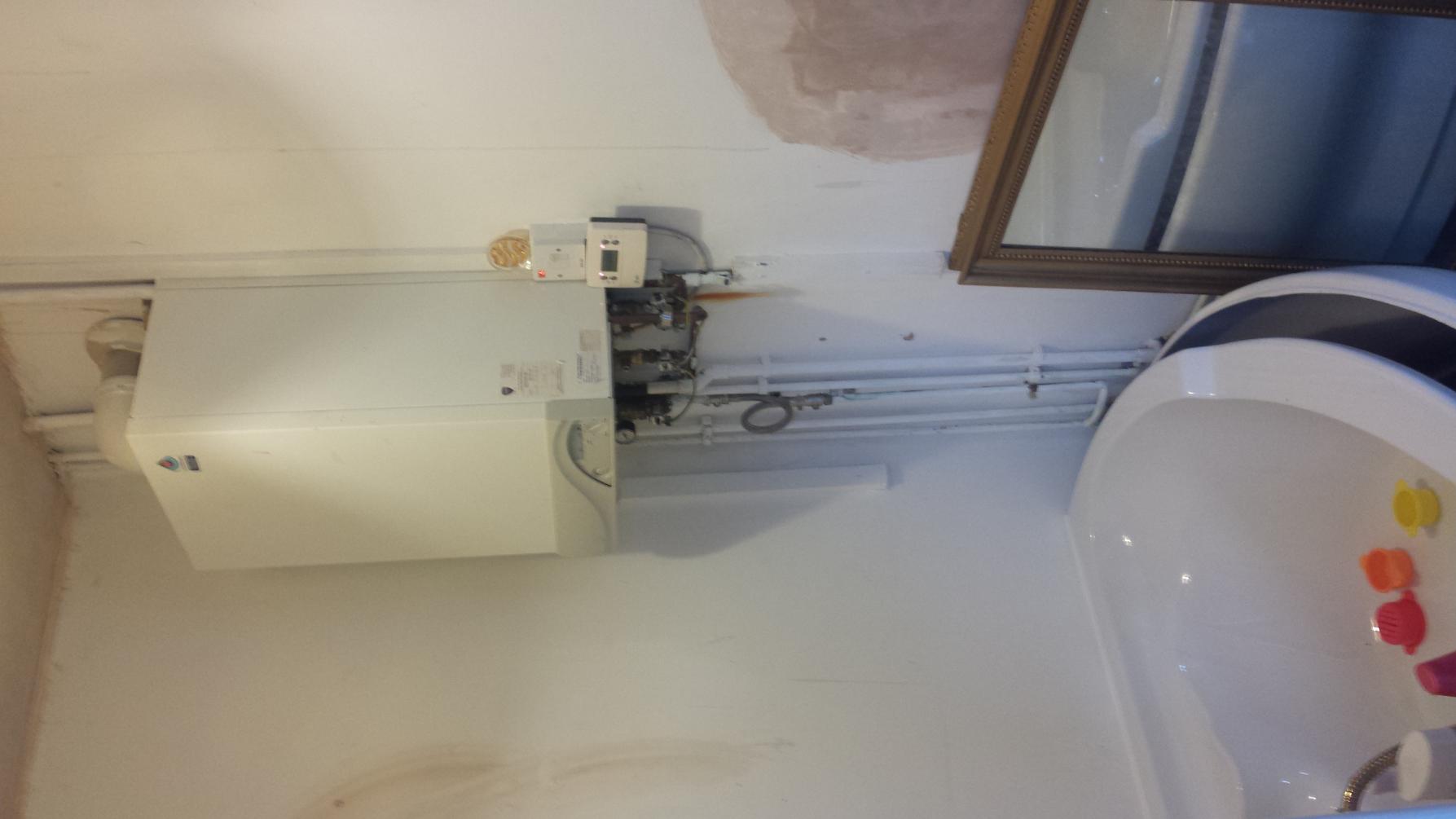

Found this in a vacant barbers I was working in yesterday.
edit: No idea why that uploaded upside down but to be fair it looks slightly kess like a dogs dinner this way up.

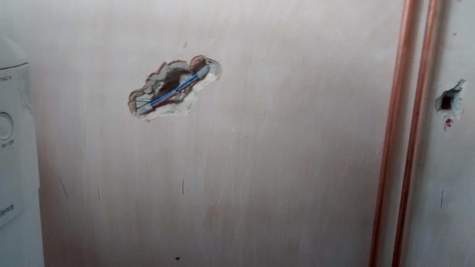

Diagonal in a wall - a no no
Prob diy'er

I believe, routing the cables horizontally or vertically is called good practise. Running them "wild" is a last resort if you cannot avoid it.
There is a good reason why it has to be shielded sufficiently.
having core drilled through a cable that was run up from a socket and the horzontally along in lintel then down diagonally where i was putting the boiler, i agree up or down from sockets and switches is good practice
so i pulled it out the wall into a surface box run it horizontal and then down in mini trunking to a second surface box which i used as a socket
i then had the sparks swearing down the phone that i had broken his ring and he wouldnt sign theat circuit off so we sacked him and got another sparks who had a clue
