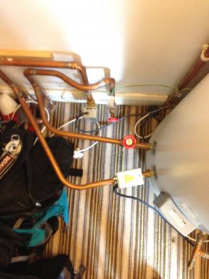

Had these on my pc for a while, A very dodgy boiler install I came across during a LGSI.
Flow and return in 22mm copper down to 15mm hep2o and a quality flue installation (yes that is daylight and its going through a void as well).
Dont know how long it was in for or who done it but no paperwork left.
DSCF0444.jpgDo you think it was going to be a Low Loss Header & then someone changed there minds???. 3rd connection down on the lefthand side of boiler is the primaries to the cylinders. Wheres the zone valve (only one) ? ,behind the 1st cylinder but where the pump ?? Yes that it on the return going back into the boiler !!!!!! nice one.
View attachment 11921Do you think it was going to be a Low Loss Header & then someone changed there minds???. 3rd connection down on the lefthand side of boiler is the primaries to the cylinders. Wheres the zone valve (only one) ? ,behind the 1st cylinder but where the pump ?? Yes that it on the return going back into the boiler !!!!!! nice one.
Someone spent a lot of money on that just a pity there plumber just didn't quite know what he was doing
I'm shocked and appalled at what Mike Jackson has had to rectify in his last few posts here. I'm beginning to think Gas Safe should be doing more and come down mega hard on these chancers, I mean what's the worst that's gong to happen to these fools? Slap on the wrist and a few future jobs scrutinised then given the green light to carry on as they were? Not kidding when I say I'm shocked and appalled at this.
Chris ,
what are the two pumps feeding to the left ? What is under the boiler rhs a secondery hot water pump ? What's the pump doing on the return to the boiler for and is there no expansion vessels fitted ?? I know is not your work just interest to find out the job specification .
also is both cylinders of one primary flow with one motorised valve ?
Yes stan the pump under boiler on right is a grundfos comfort pump for secondary return with built in timer
It's a good pump
Chris ,
Hi Stan
One does heating on the first & 2nd, the other the U/F on the whole Ground floor. (as Gray below) as for the other pump it sucks the water around the cylinders & a 22mm towel rail circuit as well as aiding & abetting the other two heating pumps it would seem (mind you all are 15/50's on speed 3) expansion vessel & loop are on the floor to the left out of shot. Job specification ??? no there wasn't one (I asked) which went along with the insulation on all the pipework not just in the plant room throughout the whole house.
