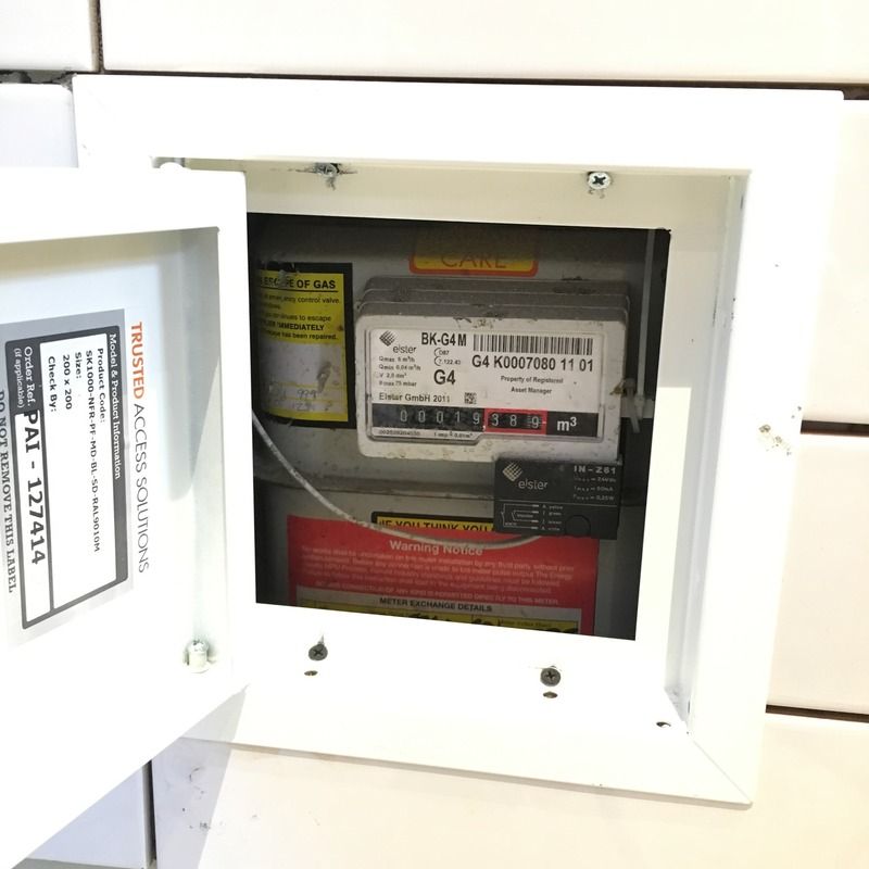

It might just be the picture but on that gas one it also looks like the top corner of the socket has been beaten out to accommodate tHe hob pipework
Doing a refurb at a well known fast food chain in Chancery Lane and the main contractor does this, told my boss and got shouted down and told not to get involved! As were not there to touch the gas just the plumbing on this one.
