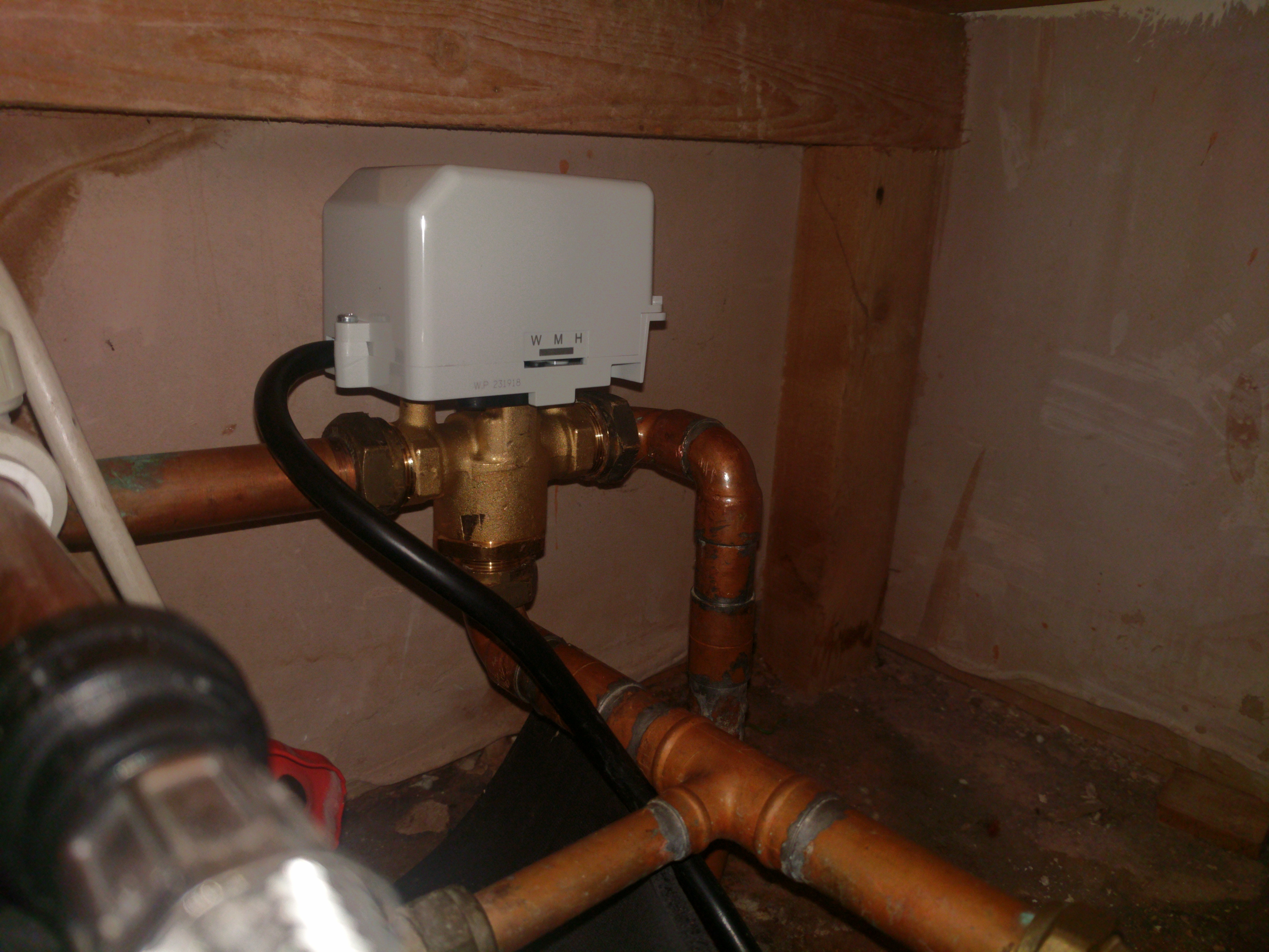

Hi. We have a baxi boiler conventional hot water system. We noticed that when the controller has hot water only selected that the radiators too get hot. I put this down to a faulty midway valve as the indicator on the valve was on w but both outlet pipes were hot. So yesterday we got a man in to drain down the system and fit a new valve. But this morning we still have the same issue. What could the problem be?

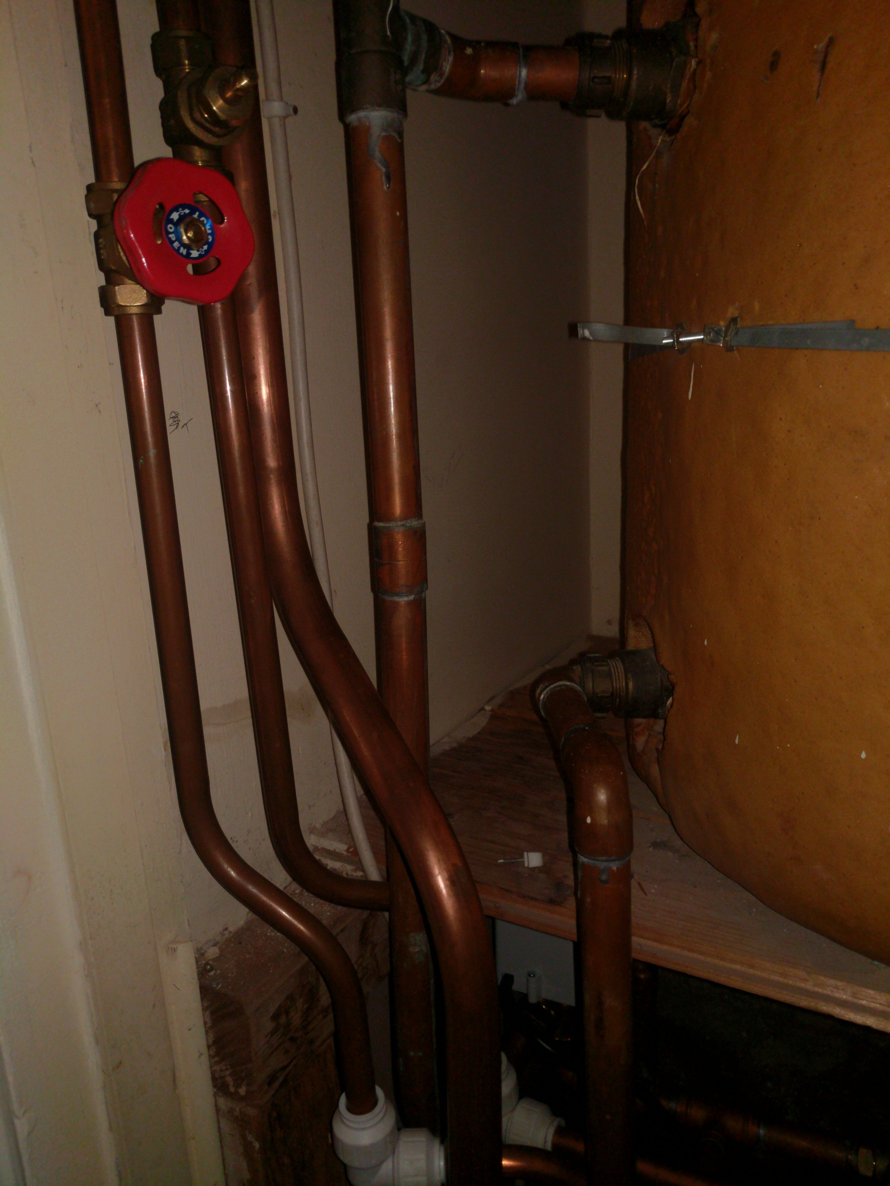

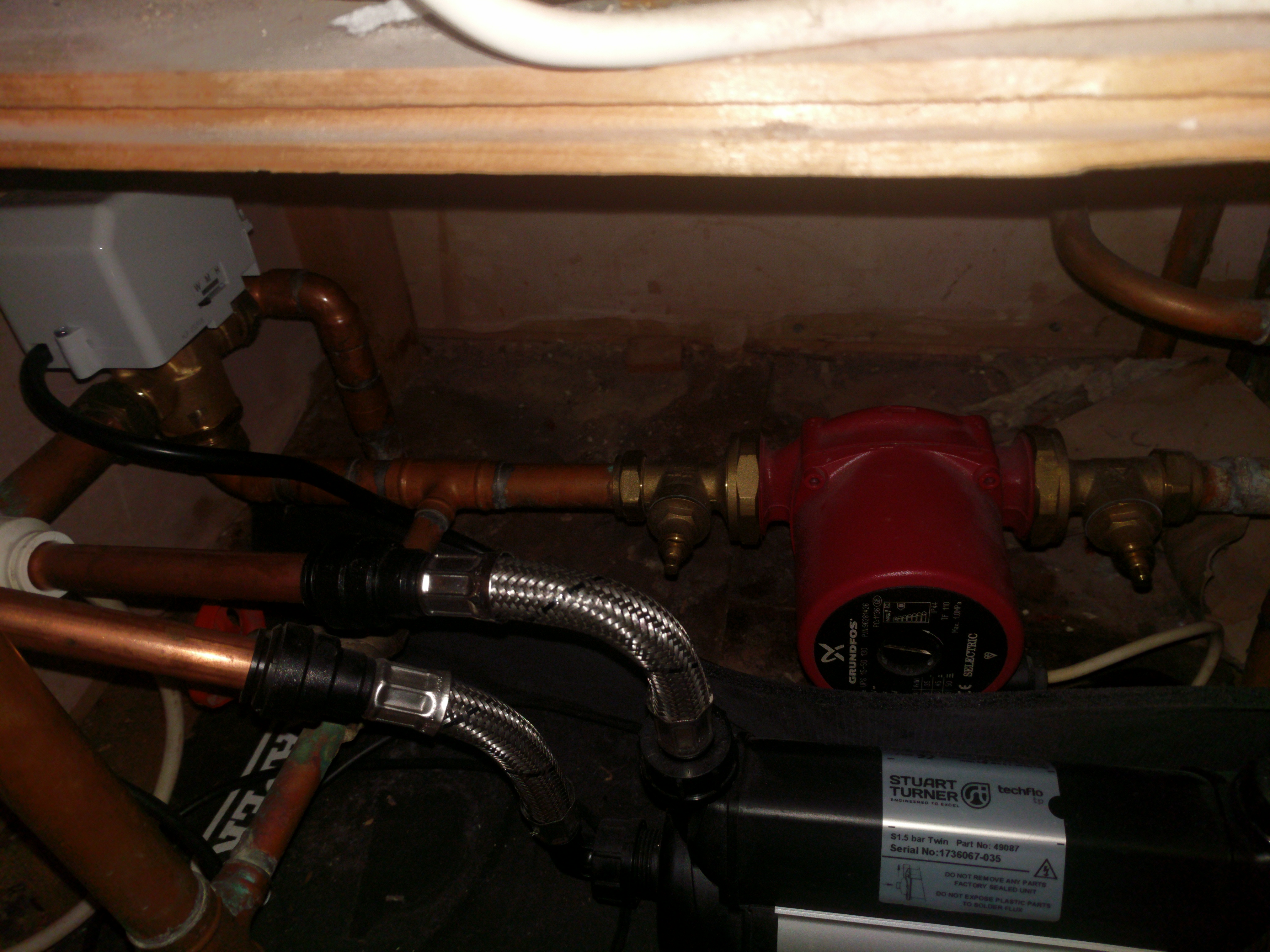

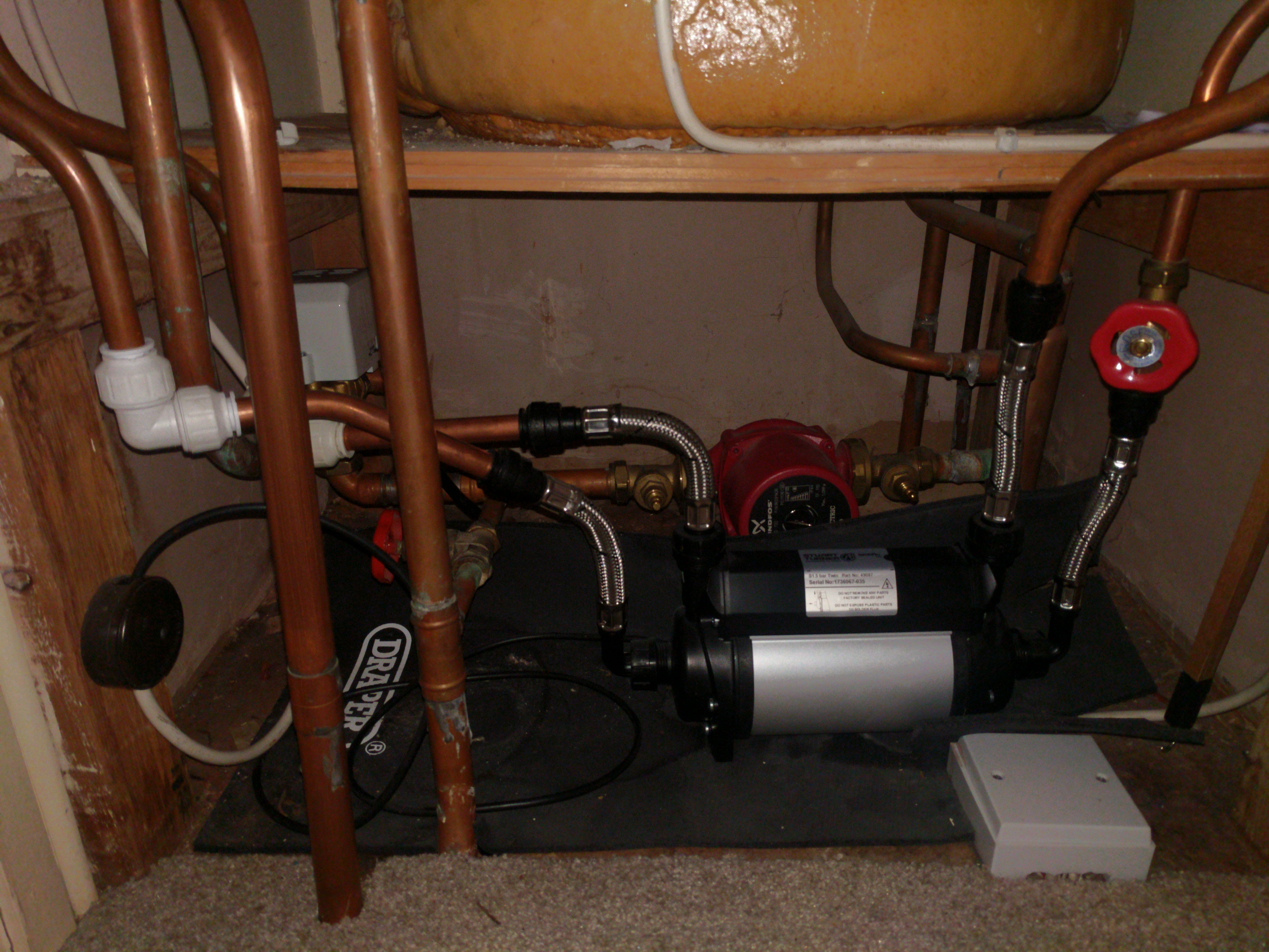

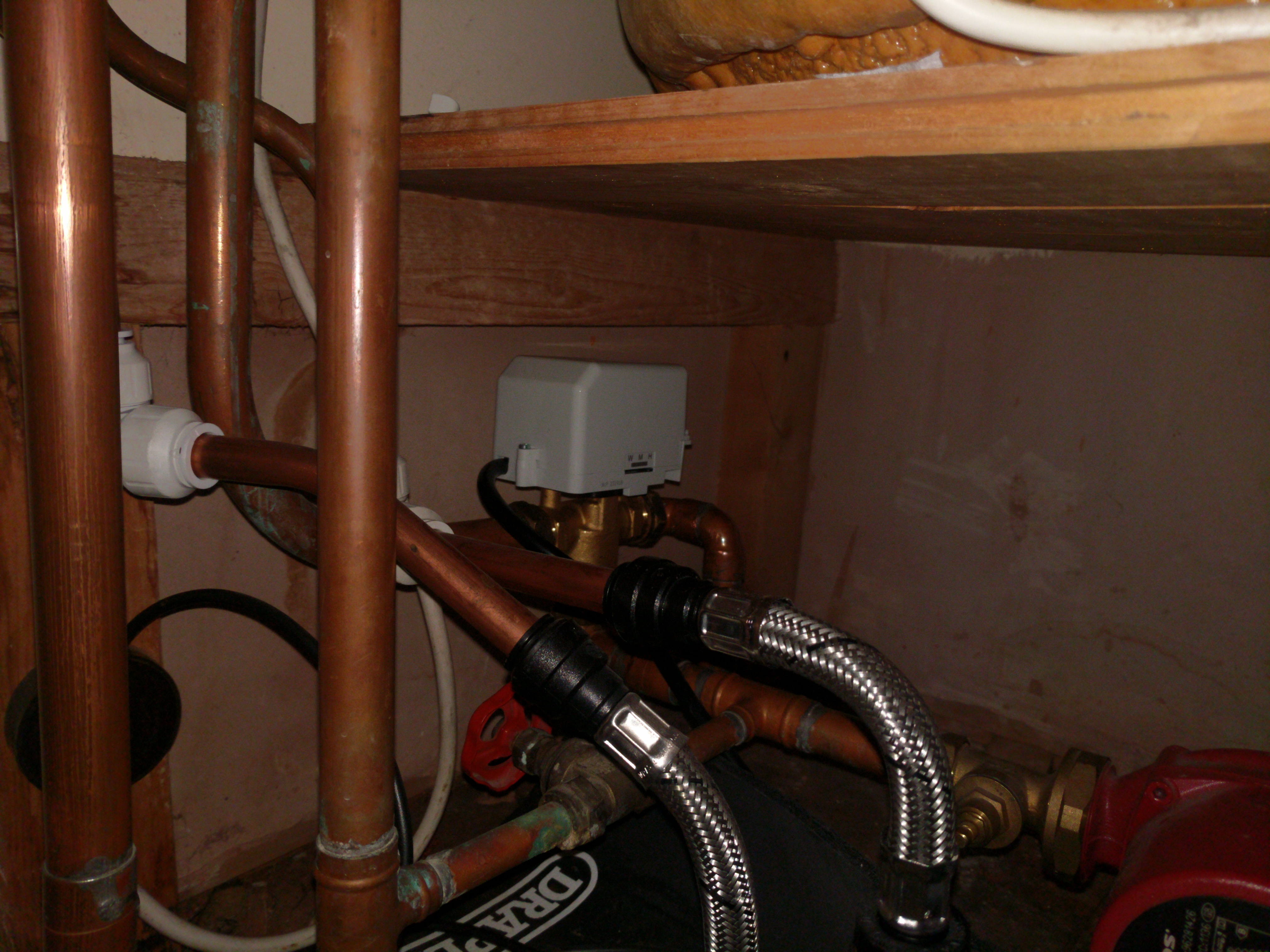

Doubt it, sounds like reverse circulation maybe occurring, which is a result of the original pipework installation. A photo of pipework arrangement in cylinder cupboard may help us point you in the right direction.
Don't really know what I'm looking for as it just looks a mess if pipework so I'm just merrily snapping away. Please let me know if you would like me to take a pic of something specific. Chris

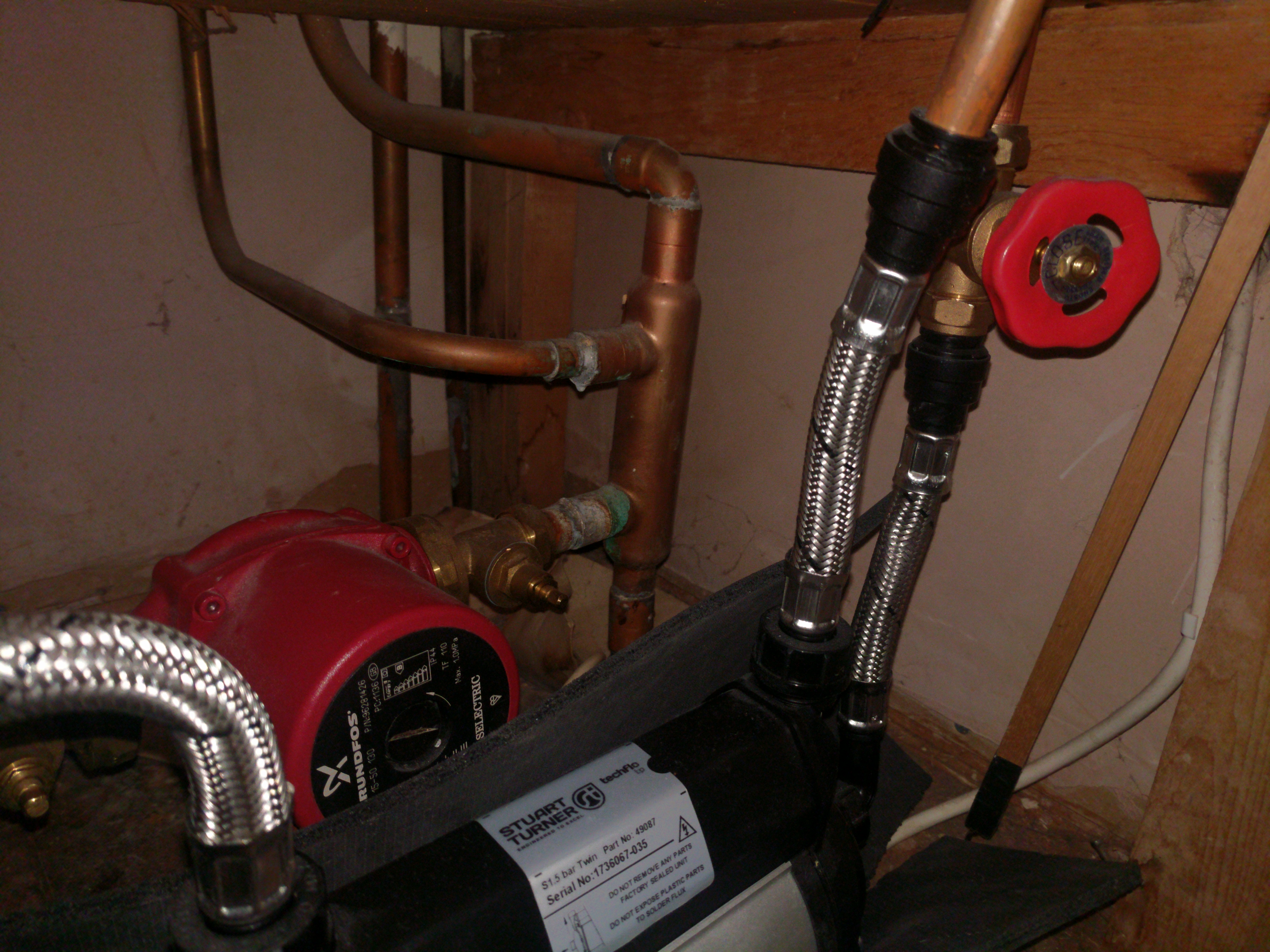

Good pics, try taking left hand side of cylinder a bit further back so we can follow pipes better
Is this what you need? Thanks a lot.
