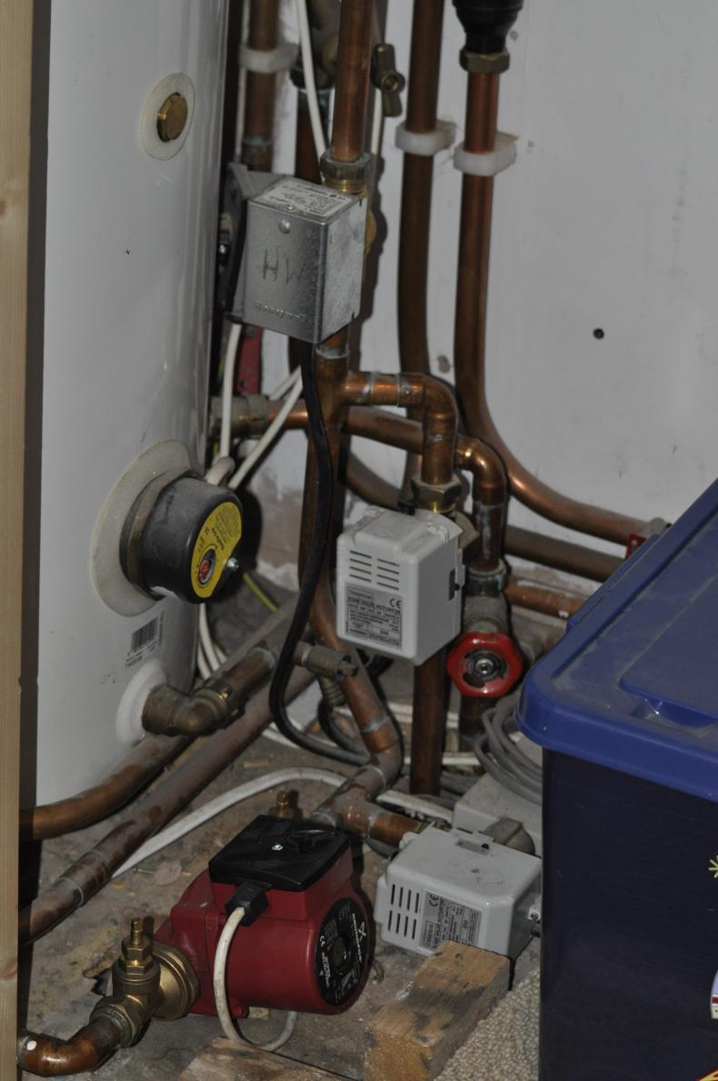

Any pictures of the valves and controls?
Yep that is correct. With everything off and then just activating either of the heating circuits the boiler will not fire up. Error code Fd no water flow.
Picture below:

Could the flow sensor have been wired incorrectly when it was replaced in June?
Possibly valves not wired up correctly. U need a GSR . Zv probs not wired correctly. Pump probs wired on to dhw demand and not other zv. Pump should be direct connection to logic heat only! Installer not competent with electrics? Flow switch probably ok but issue is with setup. Turn boiler off, put on boiler without any hot water or heating being called for and I bet pump doesn't spin...... Not connected up correctly and or flow and return back to front.

Sorry assumed new fix. Probs zv contact or when replacing pump made a mistake? Pump should still be wired direct to boiler . Where are u? Some one from forum probably help u.
