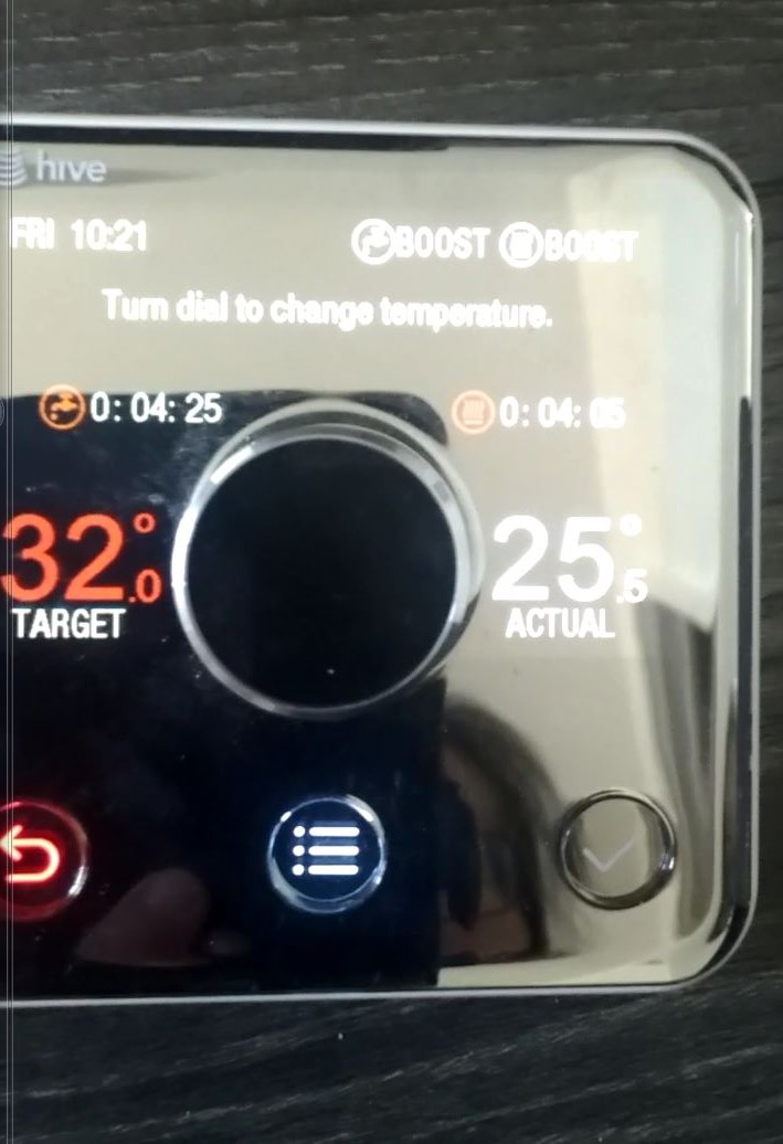

At present, the Central Heating (CH) and Hot Water (HW) are both running, immersion switched off, the drayton valves not attached, all heaters turned down. The hot water pipe in air-cupboard is very hot, and the water is hot.
It seems that when the CH is on together with HW, there is HW and the water flows; but then when the CH is off and HW on only; the hot water reverses flow? Has anyone had this issue before?
Greatly appreciate anyone help?

Morning CBW1982, yes, I am still in the same scenario. Please see photograph markups more closely, (these were how they were situated (24/04/2019). The installer, he visited 30/04/2019 and said he will leave them off and they are not hanging on the pipework at present). Thanks a lot.
If I read those photos correctly, the flow is being directed into the DHW tank through both the flow and return connections.
Boiler Flow being directed to the two two port valves (HW and CH) and the magnaclean! HW return connection connected to the Magnaclean on the flow side. Ie. Flow to flow on the HW circuit when the two port valve is opened.
Margaret, I cannot see that this installation has been plumbed in by anyone with basic plumbing or heating engineering experience.
If I include the work undertaken to switch flow and return in one if your earlier posts and your comment that the valve actuators have mbeen left disconnected - it has all the signs of the work being undertaken by someone with a very low level of understanding as to how an S plan system works.
You need a normal plumber to come in and instal the pipework in a conventional manner for an S plan system. Thereafter, to check the connections and commission the Nest controller.
Morning Margaret, thanks for the photos. Sorry to be the bearer of bad news, but as @Brambles has said that looks like it’s been done unprofessionally, (but I think you knew that). It is fixable, but not sure how you go about trying to reclaim costs from your original installer, as if it were me I wouldn’t have him back. There is an isolation valve (chrome valve circled in my edited photo) turned off, and flow is either going backwards from magnetic filter (magnaclean) or the flow comes up to a closed off iso valve and through the return. Either way for this to function as it should then it needs sorting.
Hello Brambles, thanks for the above. Just wanted to mention, in case I typed incorrect, I meant that the installer, he said he will leave the Drayton off and not attached to the pipework (it is dangling down and not 'clipped' onto the CH pipework). Hope this clarifies that part.
