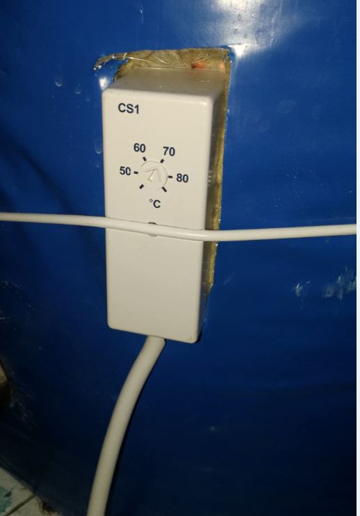

Thanks, Craig, should the temperature on the boiler be changed? or the thermostat attached to the blue cylinder. If so, what should this read? What's in the wrong location? Thanks a lot.
The thermostat attached to the cylinder should be set between 60 and 65°c, and the location of the thermostat should be 1/3 from the base of the cylinder, current it is too close to the base. These minor issues though won't be causing your issues with the hot water.

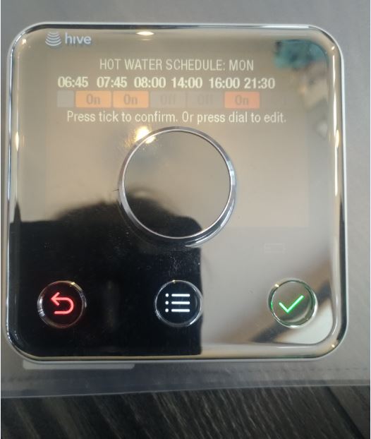

Hello, i may recall if correctly, the engineer installed the hive after it was commissioned (im not 100% certain). The hot water schedule runs set time 0645 - 0800; then 1630-2130. Due to no hot water (luke warm), the engineer says to us leave the immersion on constant

So before testing, the water was like warm, the immersion was off and made sure the water was cold where possible.
The hive pressed hot water boost 30 minutes at 25 degrees. Duration of 14 minutes remaining, the water was only Luke warm. And the full 30 minutes, the water was only Luke warm. Felt the pipe work surrounding the hot water cylinder and it was warm / cold. The boiler displayed 75 reading on screen with 1.9 bar.

hello, from your description above, hot water + heating there is hot water, but hot water boost on its own there is none except like warm water. Where would this terminal wire be? Thanks a lot.
So, if you boost the hot water via hive, could you not have turned down the temperature? I’m not up on hives, but I’m wondering if that has a separate temp control? How do you know it’s 25 degrees?
Thanks CBW1982, I note on the hot water cylinder the thermostat is is pointing to 75 degrees; the hive boost shows 25 degrees. British gas came and just turned the hive switch which allows you to adjust to temperature. Will upload photos
