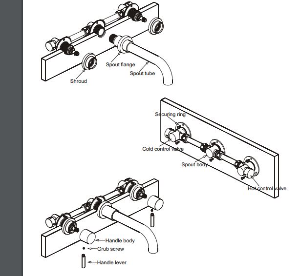

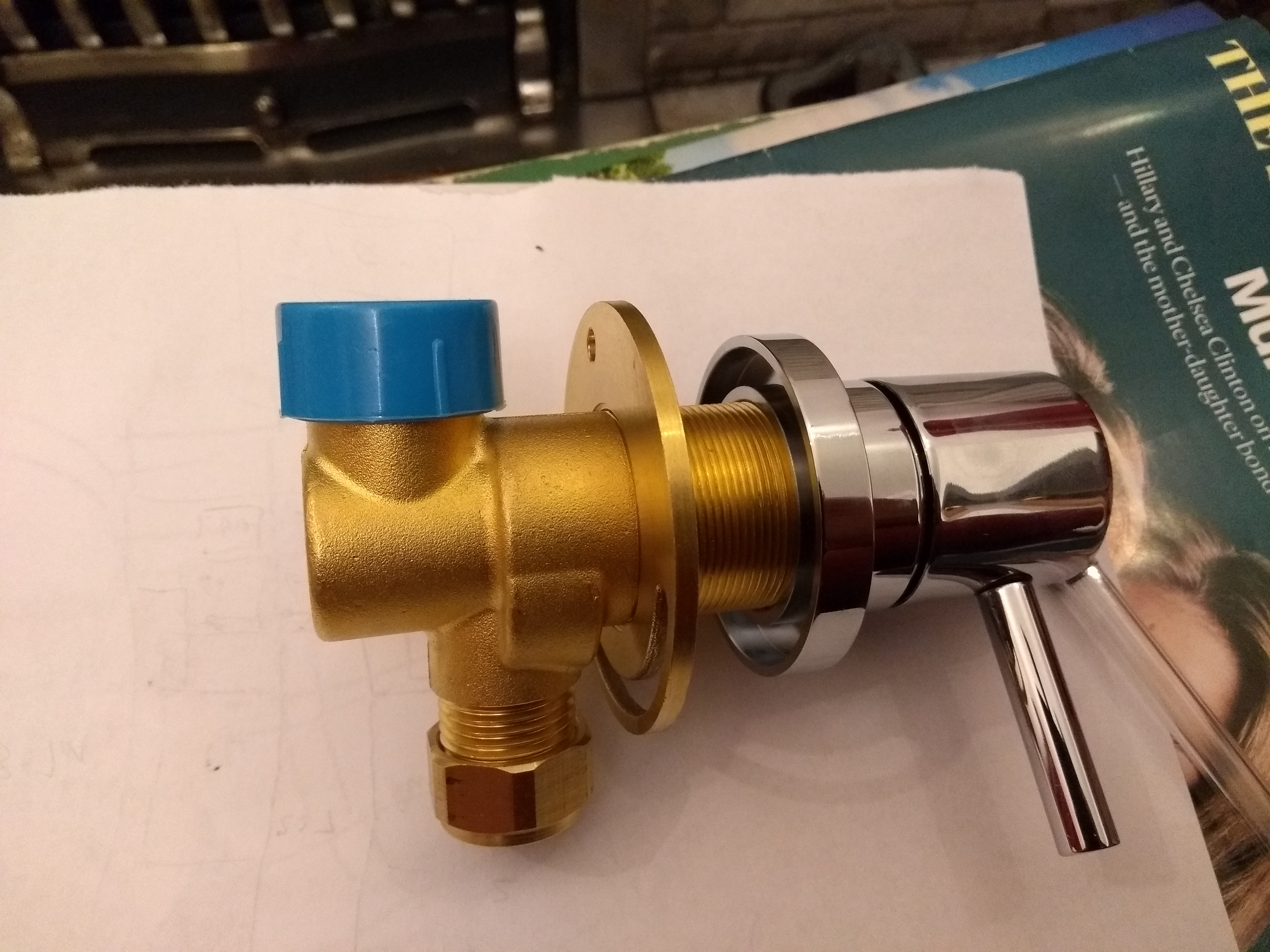

Just bought a Crosswater Fusion 3 hole wall mounted bath tap. Can't for the life of me figure how I can fit and secure it.
According to the instructions there are two screwed flanges on the body of the tap that hold the tap. Sounds reasonable except that the length of the tap and hence max space between the flanges isn't enough to take the backerboard and tile, let alone a mounting plate as well (which would be ideal).
I could cut a big hole in the backerboard and just hold it to the tile (and a thin mounting plate) but that seems like a bodge as the plate will need well sealing to the backerboard.
Any ideas. Thanks

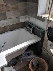

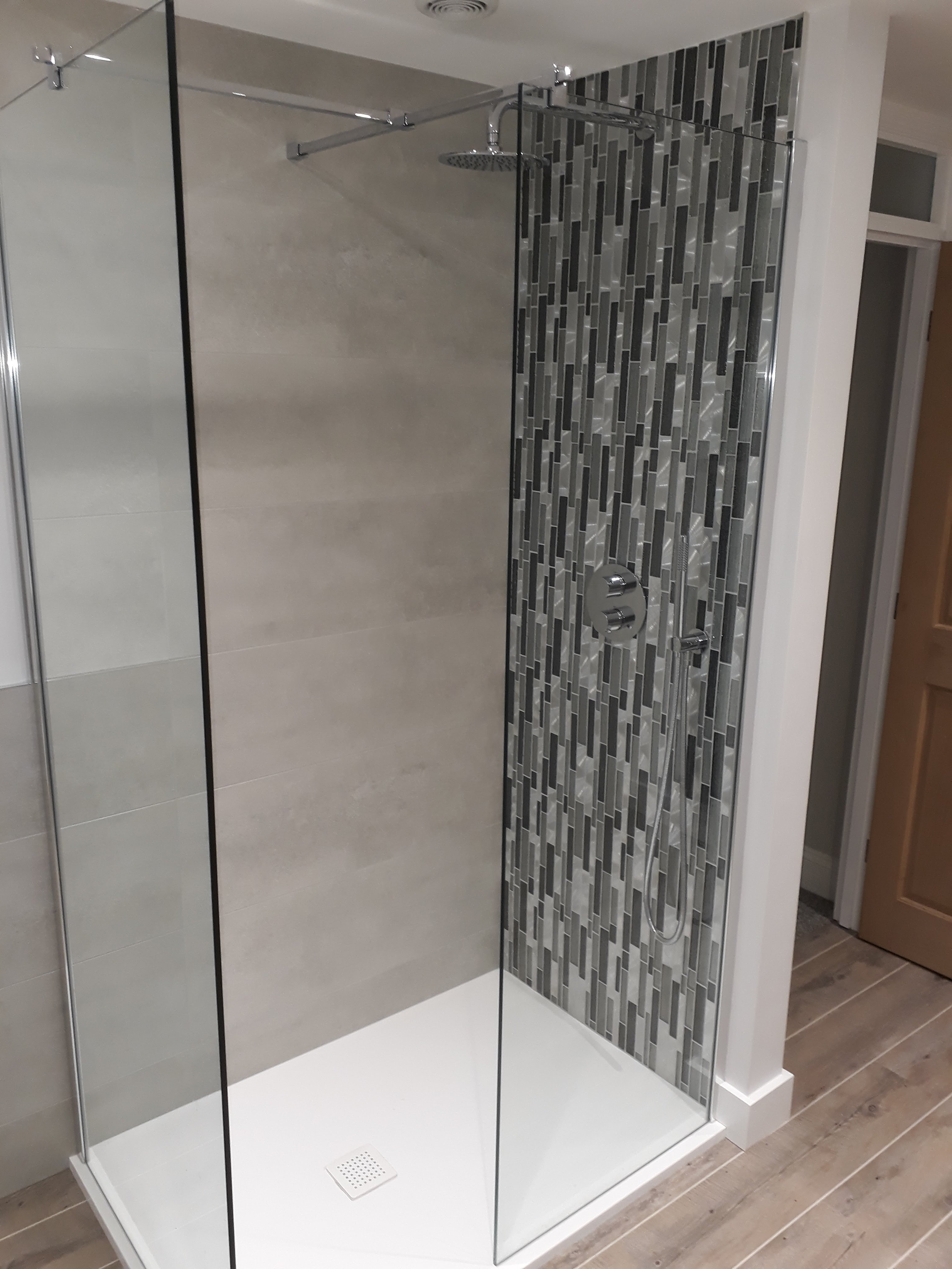

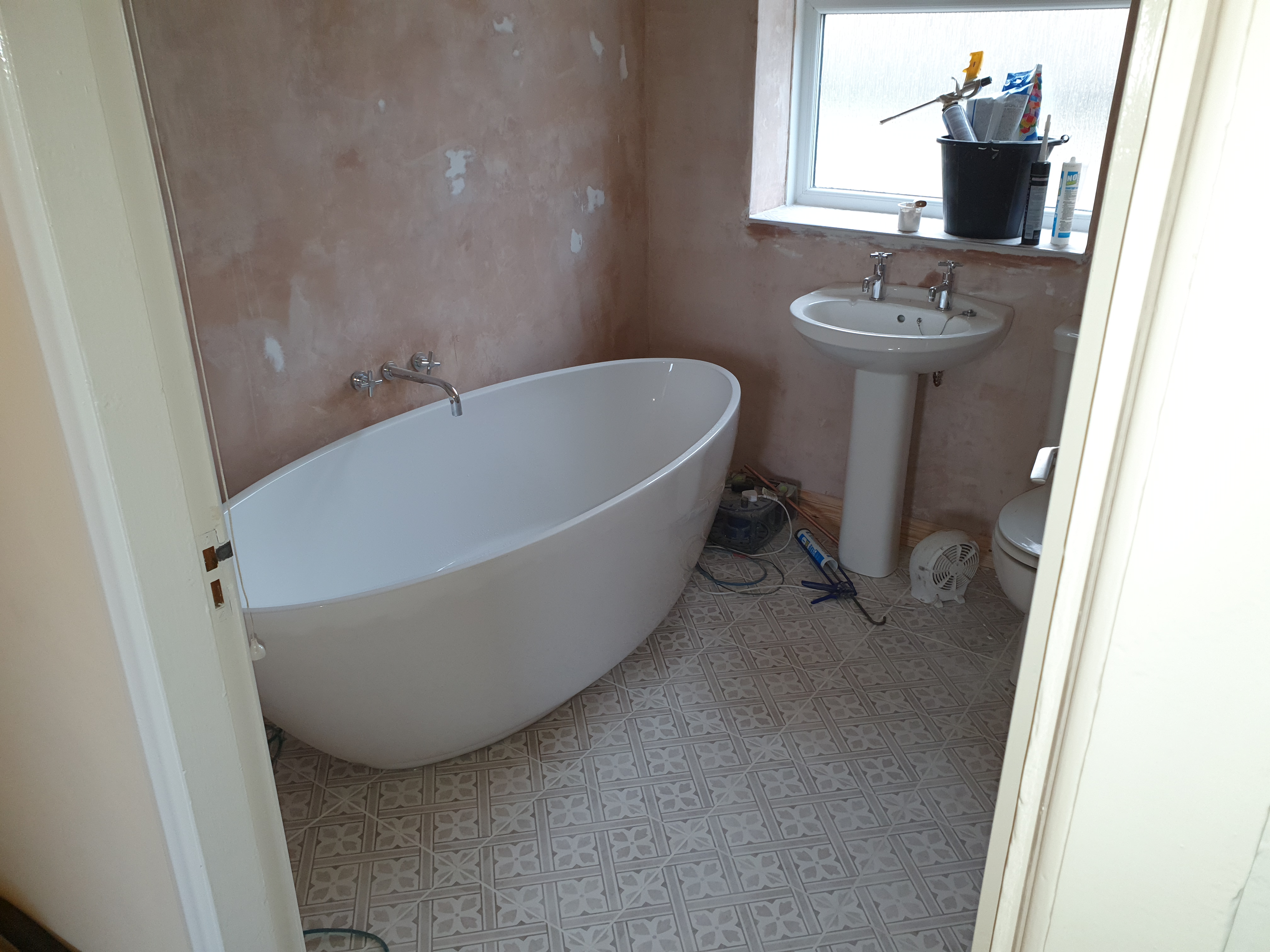

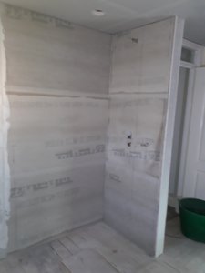

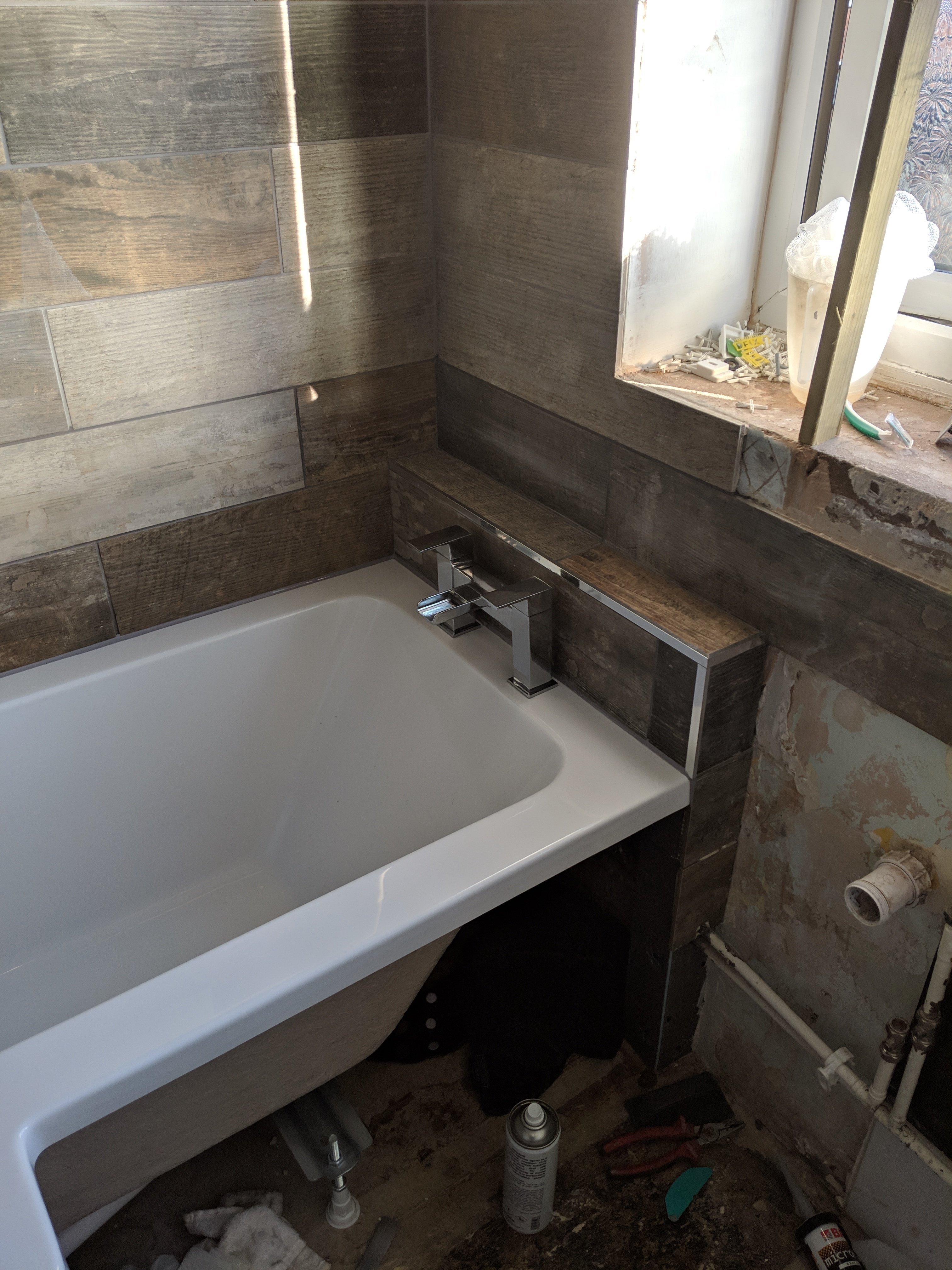

That's is what I would do the tap has fixings holes which would screw to the timber construction you could do something like this the plumbing will be hidden in then studwork and covered with Wedi tile backer board the tiled . Kop

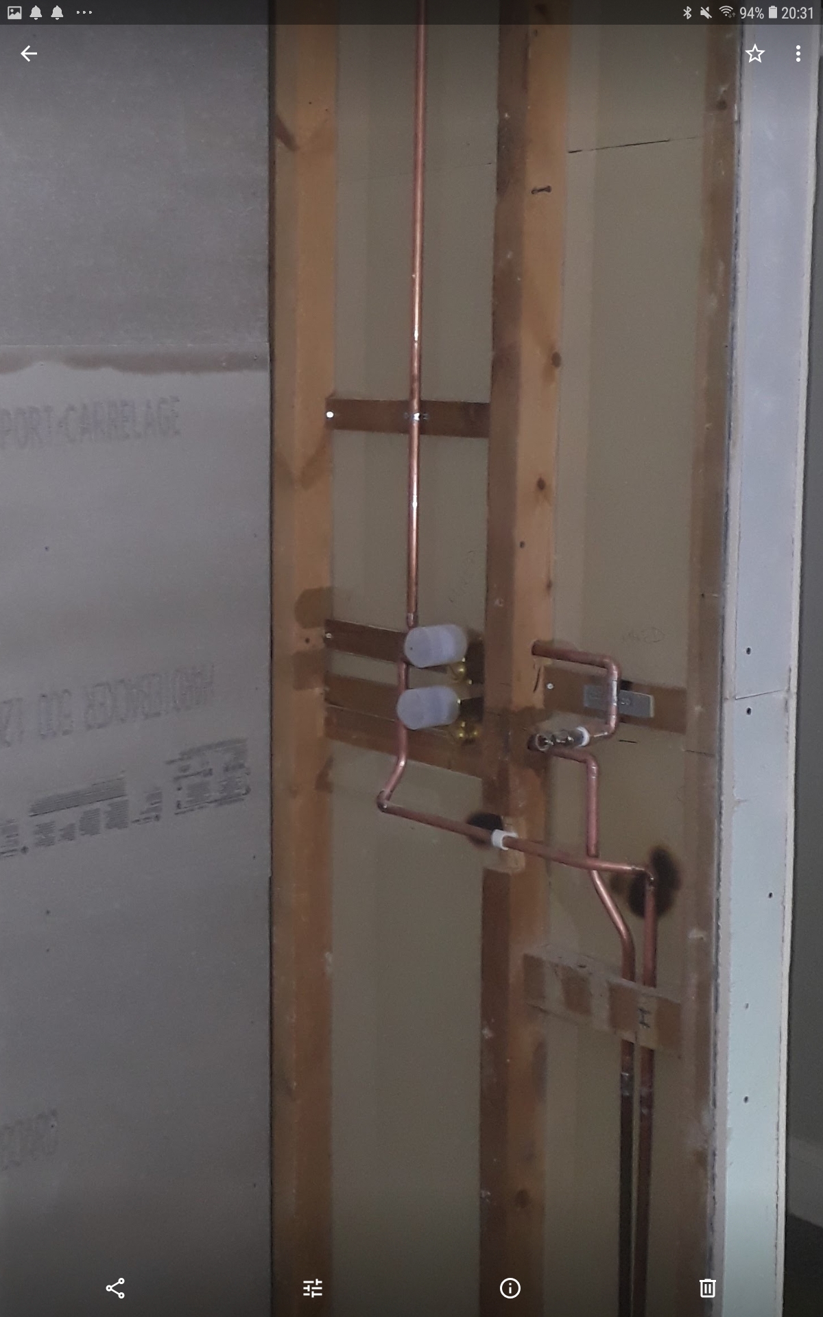

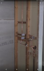

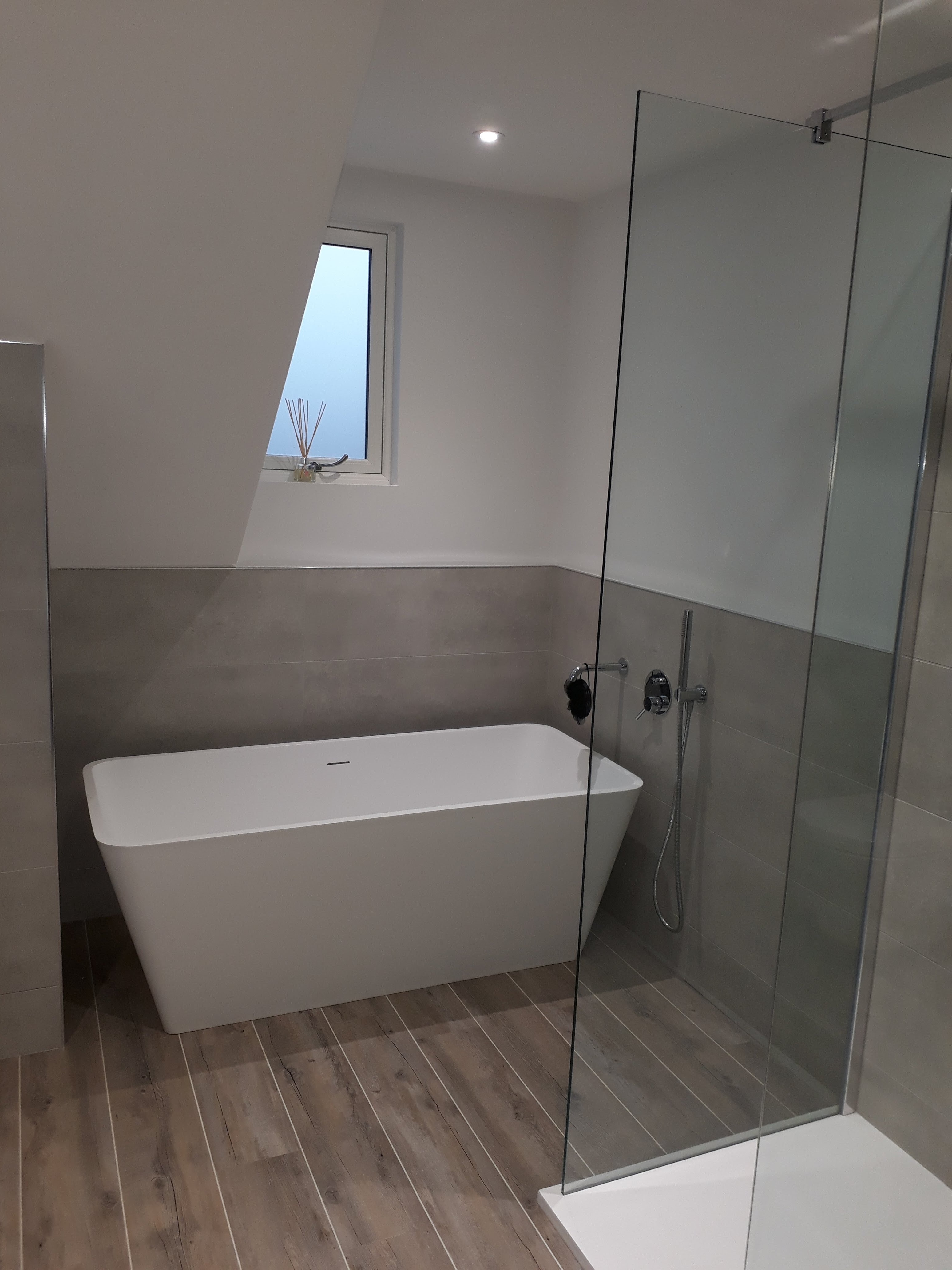

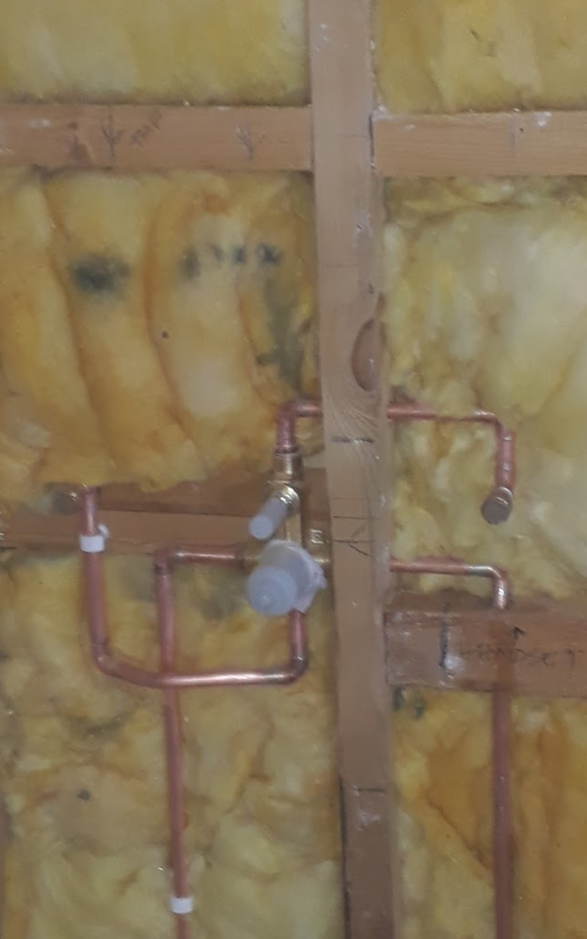

Same principle Gilbert construct your stud work fit the brassware to timber supports and connect the water supplies test out heres another one I did give you a idea the most important thing I'd correct positioning and fitting at the correct depth in the wall . Kop

OK Thanks KOP. I'll give it a go. It just seemed that the taps were designed to be cleverer than that. ( Maybe so but not designed properly 🙂 )

I would call the Crosswater Technical team in Dartford, they are quite good with their advice.
The tap that you have is the model intended to be fitted to a full length composite bathroom / shower wall panel, with a stainless steel stiffener plate behind it. Hence the (narrow) width of the gap between the rear face of the tap and the backing nut.
