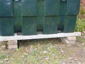

I was sent out to this because the delivery driver refused to deliver oil, it had been moved three days previously, onto a new stillage! Obviously somebody thought it was ok.ImageUploadedByTapatalk1356044072.208710.jpg

Another picky of the same tank laid on 4 x 2metre 100mm x 60mm concrete lintels or at least it should have beenImageUploadedByTapatalk1356044365.461992.jpg
Yes, and no they haven't been paid for the work as far as I know
