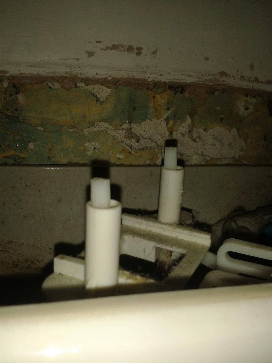

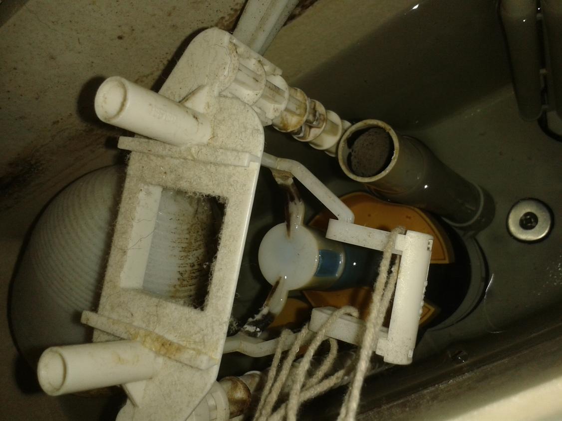

hi, my toilet push button broke and ive tried looking online at the usual places screwfix etc but cant find any i think will fit or work.
heres my toilet, when you pull the string i put on the handle its attached to it comes up and the toilet flushes.
when you do that please two little rods appear out of those tubes
so could anyone out there point me in the right direction or link to somewhere which would sell a push button which would work with this?
many thanks
I'd put a dual flush Fluidmaster in there, about £11 from Screwfix and clean out the cistern.
What he said.
this will be a lot quicker than searching for spares.
i can't say I have seen that type of flush valve and I change approx 3 a week.
Thanks for the quick reply, I'm new to this and haven't a clue what I'm doing so is there a thread her to show you how to do it? Also the hole where the button was is 50mm so is that standard button size?
your photo looks like an "impulse rapide" flush valve - the buttons can still be got maybe from ebay ?
Pro45B are also the dogs for b n q specials…. until the hole for the BV is so tight to the corner of the cistern the float won't slide!!! them jobs you think are going to be 15 min………..
This is a Yellow pivot Arm flush valve Yellow Pivot Arm Flush Valve Black Base. As you can see, this is just for the valve, but if you email or call Lunns they will be able to help regards push button.
Although as others have suggested it may be more economical to replace with a Fluidmaster or other valve with a larger diameter push button. The Viva Skylo flush valves come with a large chrome disc that the PB inserts into if you have a large hole.
Just been there, done that, just b4 Christmas. TOOK ME HOURS TO SORT OUT!
I think I've managed to fit Fluidmaster valves in all the toilets except concealed. Did one the other day and the hole was too small for the push button to fully fit in so you can fit the button surround and reverse the large retaining nut.
