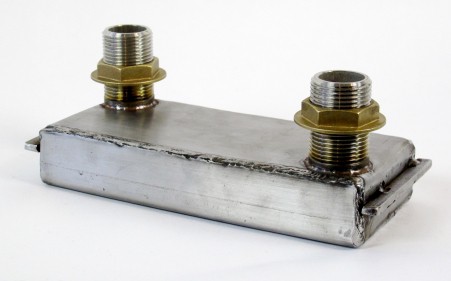

Hello everyone,
I want to be able to set up a wood burning stove utilising a back boiler in a situation where I can’t incorporate an electric pump, ideally heating a water tank and if possible a radiator. I’ve read a lot of info on this but the views seem mixed. Some systems I understand incorporate a radiator to prevent the boiler exploding in event of pump failure, therefore this same method is surely able to do what I want? Or is there a better way?
Regards,
Alex
